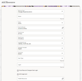

3. Click Add Child Resource.
4. Select Bucket to add a new bucket in the Resource type.
5. Enter the required details and click OK.
6. Click
Add child resource and select
Technician from the
Resource type drop-down list. Click
OK.

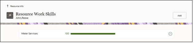

7. Select the required work skills to this technician. Click
Save.
