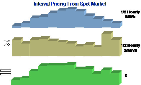

Interval Pricing Rate Application
Interval Pricing is the term used to describe applying interval prices to interval quantities to arrive at a bill calculation line item.
