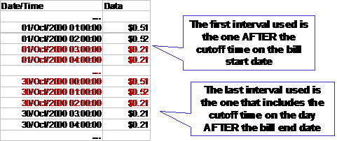

Current Day Option
• Assume that the consumption period is from the 1st of October through the 29th of October.
• Assume the cutoff time on the service agreement is 2 a.m. and the start day option is Current Day.
To determine the starting interval, the system finds the first interval after the cutoff time on the billing start date. The system uses all the intervals up to and including the cutoff time for the DAY AFTER the billing end date.

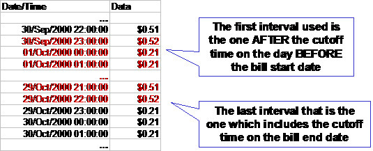

Previous Day Option
• Assume the cutoff time on the service agreement is 10 p.m. and the start day option is Previous Day.
To determine the starting interval, the system finds the first interval after the cutoff time on the DAY BEFORE the billing start date. The system uses all the intervals up to and including the cutoff time for the billing end date.
