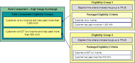

We'll use the following example to help illustrate these points. Assume a rate component is only eligible if:
• The customer is a low income customer and has used more than 1,000 kWh
• OR, the customer isn't a low income customer and has used more than 500 kWh
This rate component requires two eligibility groups because it has two distinct conditions:
• IF (Customer is low income AND the customer has used more than 1,000 kWh)
• IF (Customer is NOT low income AND the customer has used more than 500 kWh)
If either condition is true, then the rate component is eligible.
You'd need to setup the following criteria groups in order to support this requirement:
Group
No.
Group Description
If Group is TRUE
If Group is FALSE
1
Customer is a low income customer and has used more than 1,000 kWh
Eligible
Check next group
2
Customer is NOT a low income customer and has used more than 500 kWh
Eligible
Ineligible
