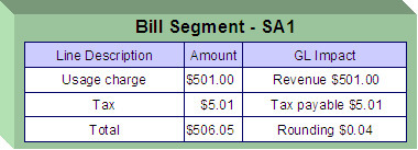

The following is an example of a simple bill segment with three bill lines.
The first two bill lines are calculated using simple rate components that have a precision of .01. The last bill line is special, it rounds the bill up to the next highest 0.05 (this is an example from a country that doesn't have cents, their smallest coin is 0.05). The following would be necessary to calculate the last bill line:
• The rate component would be an exact charge rate component
• Its value (i.e., the exact charge) would be calculated using a value calculation algorithm that sums the first two rate components and rounds them up to the nearest .05. Refer to the RCVL-RNDXRF algorithm for a value calculation algorithm that can perform this function.
