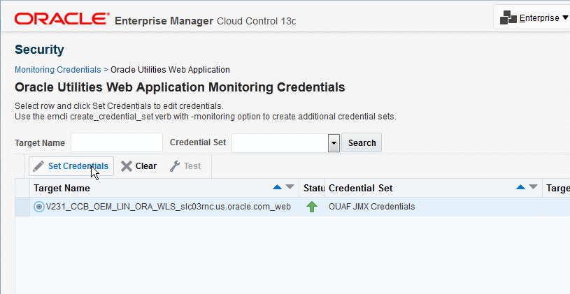

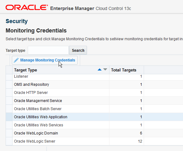

- Configure monitoring credentials. This task creates the monitoring credentials for
the web application, web services, and batch server targets. It involves navigating to and enter the JMX credentials for all three target types. For example, the
following steps configure the credentials for the batch server. Follow the same steps for the
web application and web services targets.

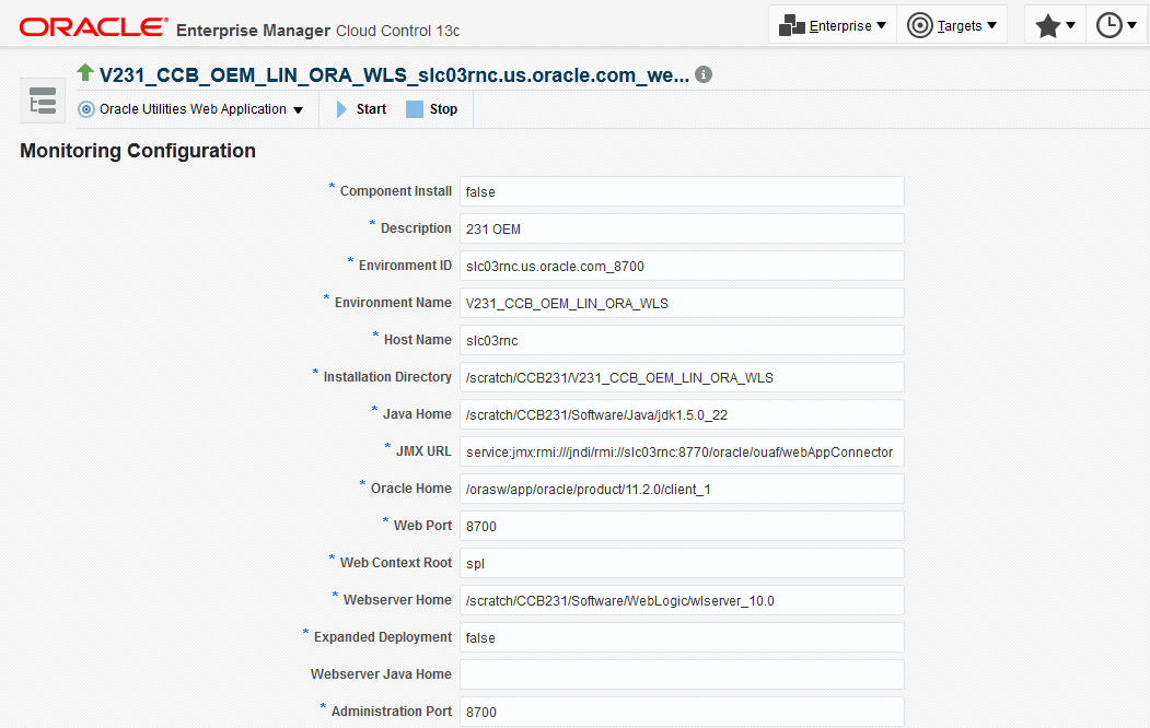

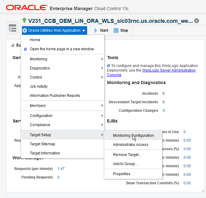

- Set up monitoring configuration. For all Framework version 2.2.0-based environments,
ensure that the target monitoring configuration contain the appropriate settings for Java Home
and Oracle Home, Web Server Home and Web Server Java Home values. These are the environment
variables that are set in the host before you run splenviron.cmd/sh. Note that Web Server Home
is the location on which the WebLogic software is installed (e.g.,
/spl/middleware10.3.3./wlserver_10.3). Web Server Java Home is the Java location that is used as JAVA_HOME by the Web Server. For WebLogic servers on Linux, it is same value as JROCKIT_HOME. Set up monitoring configuration for all target types.
