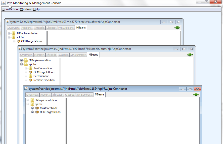

  2. JMX should be configured on the target environment. To test this, use jconsole and connect to the JMX servers using the JMX URLs. You can search the WebLogic log for the Web and EJB JMX URLs. Examples:
    service:jmx:rmi:///jndi/rmi://{host}:{ejbJmxPort}/oracle/ouaf/ejbAppConnector
    service:jmx:rmi:///jndi/rmi://{host}:{webJmxPort}/oracle/ouaf/webAppConnector
    The threadpoolworker logs would have the batch JMX URLs. For example, service:jmx:rmi:///jndi/rmi://{host}:{batchJmxPort}/oracle/ouaf/batchConnector
    In FW 2.2, this would be service:jmx:rmi:///jndi/rmi://{host}:{batchJmxPort}/spl/fw/jmxConnector
    Make sure you can connect to the URLs and that the OEMTargetsBean is present, as illustrated in the following image:
    Here, the host should be fully qualified domain name.
    The OEMTargetsBean is present and the connections to the URLs are available after configuring JMX on the target environment.

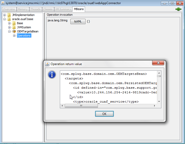

    Expand the OEMTargetsBean, click Operations, then click the toXML button. A window should popup and return the XML of the targets that will be discovered. Do this for each JMX connection.
    Determine the XML of the targets to be discovered for the JMX connection by expanding OEMTargetsBean, selecting Operations, and clicking the toXML button.

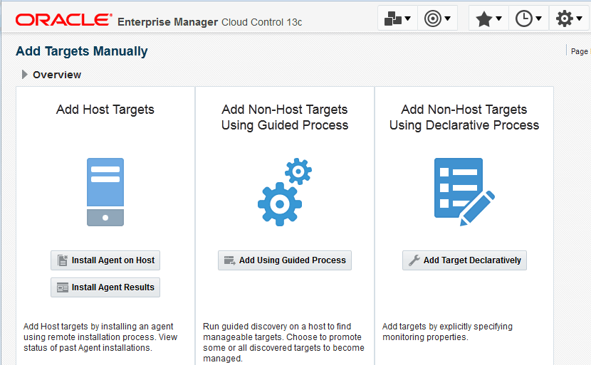

  4. The WebLogic domain/Fusion middleware must be discovered. To do this, perform the following:
    • The WebLogic admin server must be started. Verify that it is by logging into the WebLogic console.
    • Discover the WebLogic domain and Fusion middleware using guided discovery. On the grid console, go to Setup, and then Add Targets, and then Add Targets Manually. Select the following options on the page:
      Selecting the Setup, Add Targets then the Add Targets Manually menu items initiates the discovery of the WebLogic domain and Fusion middleware.

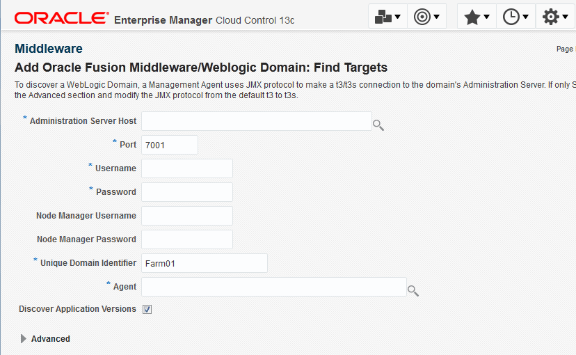

    • Click Add Using Guided Process, enter the entries for the WebLogic admin server, then continue until the WebLogic domain/Fusion middleware is discovered.
      If WebLogic is configured with SSL, use the t3s protocol.
      Selecting the Add Using Guided Process option facilitates the data entry of the WebLogic admin server details and the discovery of the WebLogic domain or Fusion middleware.

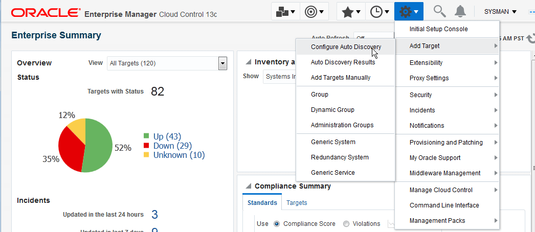

  1. Log in to Enterprise Manager.

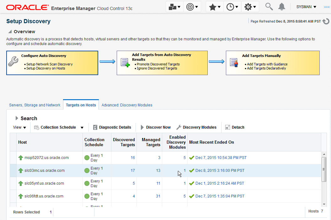

  2. Choose Setup, and then Add target, and then Configure Auto Discovery.
    Figure 7-1 Selecting Auto Discovery

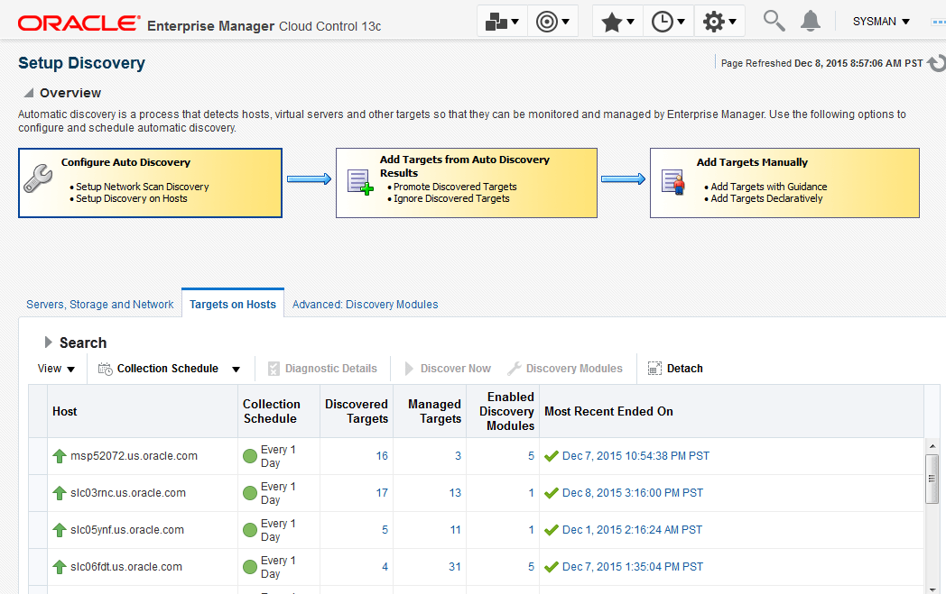

    Start the environment discovery configuration by navigating to the Setup Discovery page.

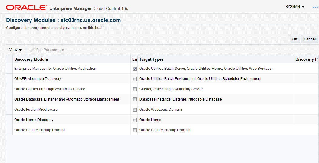

  3. On the Setup Discovery page, click the host where discovery is to be run, then click the Discovery Modules button.
    Figure 7-2 Setup Discovery
    Select the host in which to run the discovery and the appropriate modules.
  4. Ensure that the Enterprise Manager for Oracle Utilities module is on the Discovery Module list.
    Figure 7-3 Verifying the module
    Ensure the appropriate discovery modules appear on the list.
  5. Once back on the Setup Discovery page, select the host again to enable the buttons at the top. When the desired host is selected, click the Discover Now button.
    Figure 7-4 Running the discovery
    After setting up the discovery details, initiate the discovery by clicking the Discover Now button.
