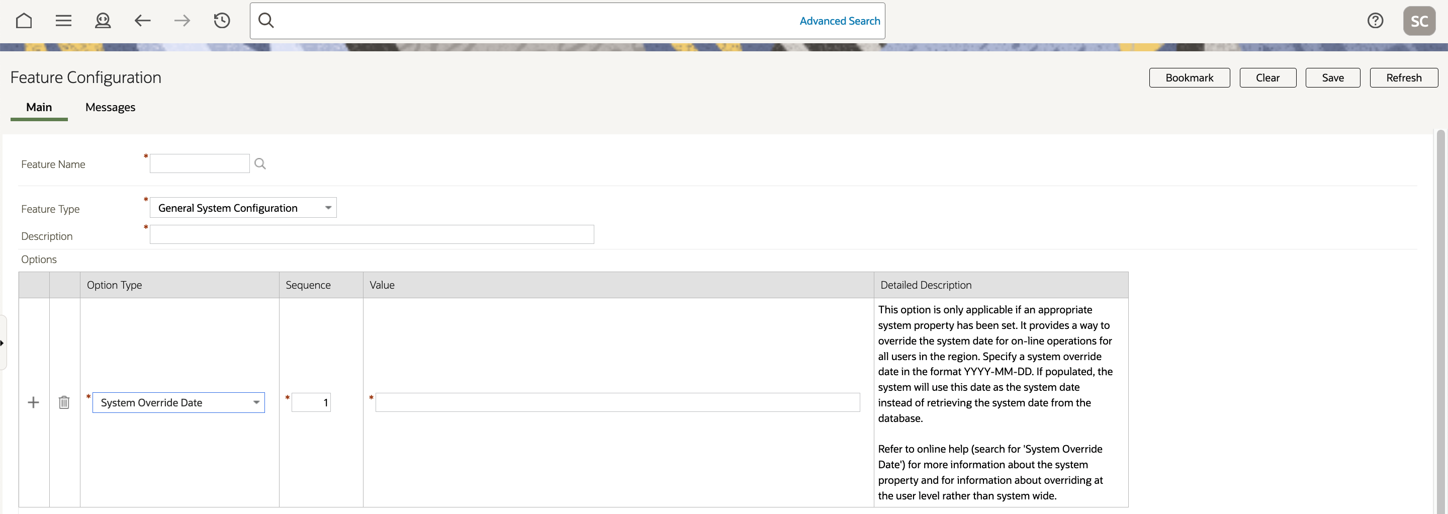

• To set the feature at the global level for an environment, navigate to the
• Administration menu,
General,
Feature Configuration Add menu option and add a
General System Configuration Feature Type with the
System Override Date option in
YYYY-MM-DD format. For example:
Figure 37 – Feature Configuration

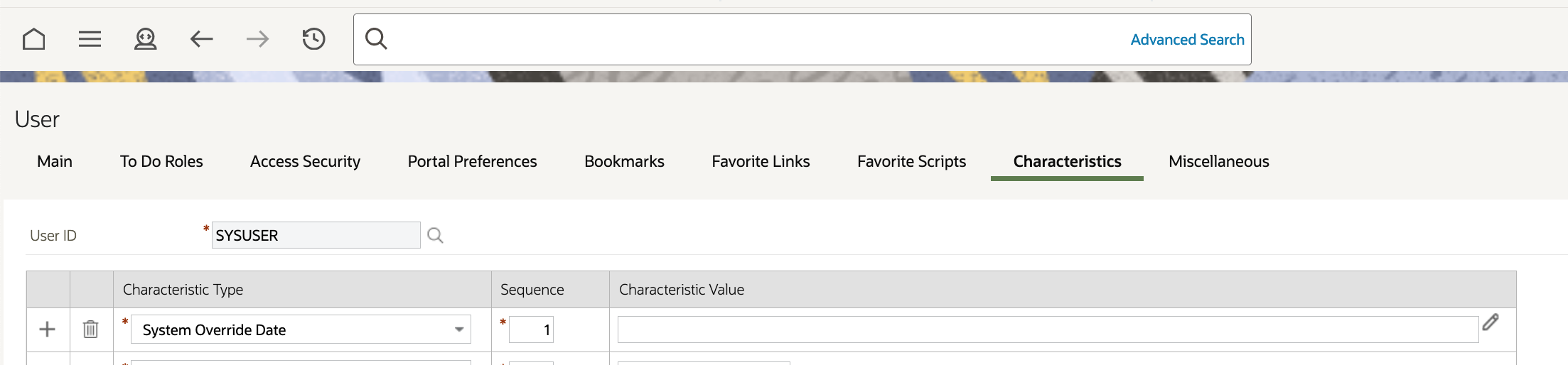

• If individual test users wish to use different dates, they can set the feature at the user level. This feature does not require the global override setting to be used but if the global override is also used, then this user specific setting is used. To set the date override at the user level, add the
Overridden system date Characteristic Type to the individual user record (through
Security,
User Search menu option) with the Characteristic Value set to the desired date in
Figure 38 – System override for individual users
When the facility is active the following applies:
• The facility will only be active if the spl.runtime.options.allowSystemDateOverride parameter is set to true in the relevant spl.properties file.
• If the system override through feature configuration is set, then all users using that channel will use that date for any transactions. If the feature configuration is not set, then the default current date (in accordance with the database server) is used.
• If users have system date overrides as characteristics, then that user for that channel will use that date regardless if the system override is set or not.
