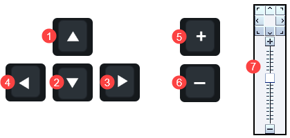

Navigate Menu
The Navigate menu lists the Viewer's navigation keyboard shortcuts and allows you to select whether the Viewer's Pan and Zoom Control is displayed in the Viewer Drawing Area. Navigation keyboard shortcuts use the keyboard arrow keys and the numeric keypad plus (+) and minus (-) keys (not the keyboard's number row).
Option
Description
Keyboard Shortcut
1
North
Moves the map to the north.
Up
2
South
Moves the map to the south.
Down
3
East
Moves the map to the east.
Right
4
West
Moves the map to the west.
Left
5
Zoom In
Zooms in on the map to show a smaller area in more detail.
Plus
6
Zoom Out
Zooms out on the map to show a larger area.
Minus
7
Show Pan and Zoom Control
Check box allows you to select to display the Viewer Pan and Zoom control; deselect to hide the control.

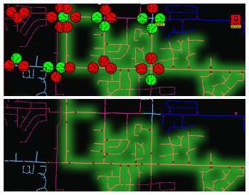

Big Symbols
Allows you to toggle the display of Big Symbols, which are enlarged versions of normal symbology that allow you to see certain device types and conditions when zoomed out. In the following image, Big Symbols are active in the top view and inactive in the bottom view.Two screen captures of the Viewer drawing area with large symbols on the top capture and small symbols on the bottom.
