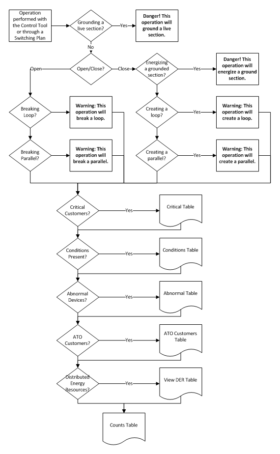

The following flow diagram below shows the basic logic of the Look Ahead dialog box.
Flow diagram showing the basic Look Ahead Tool logic.
