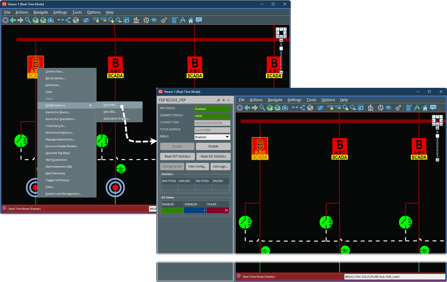

Users that do not have the SCADA maintenance privilege may still want to view and control the FEP state. This can be done by selecting a device having valid Flex SCADA connections in the Viewer, and then selecting the View FEP... option from the SCADA Options context menu.
This will open a dialog box showing the current state of the FEP and provide you with the following functionality:
• Enable/Disable the FEP.
• Swap the active connection to the IED.
• View the FEP diagnostics.
• View and reset FEP statistics.
• Reset the statistics for all IEDs on the FEP.
