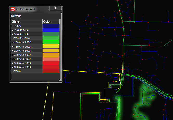

.Screen capture of the Viewer with the Color Legend for colors corresponding to current ranges.
Currents: the current range

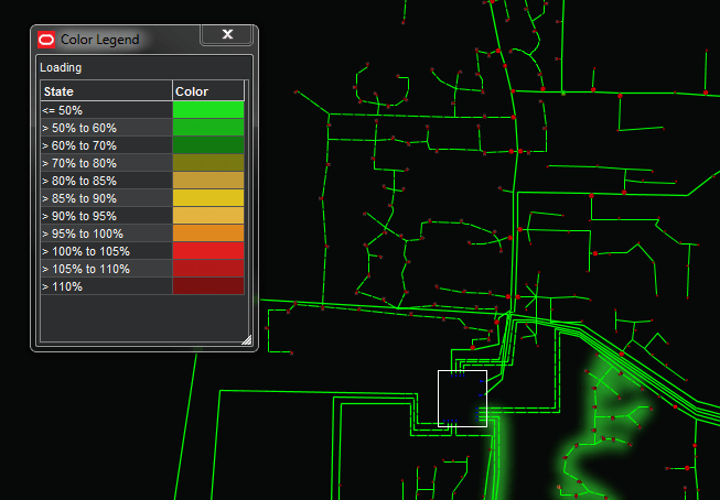

Screen capture of the Viewer with the Color Legend for colors corresponding to loading (per unit current) ranges.
Loading: the per unit current range.

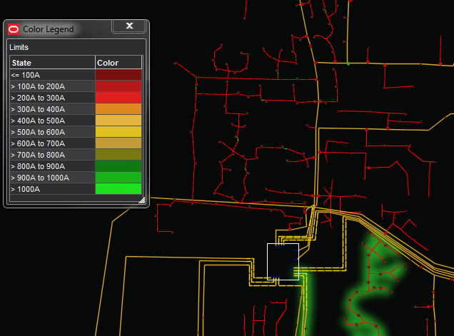

Screen capture of the Viewer with the Color Legend for colors corresponding to limits ranges.
Limits: conductor Amp limits.

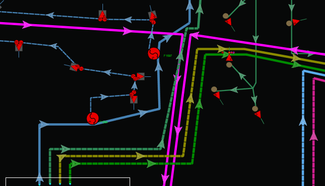

Flow Direction
The Viewer will render any of the view options with flow direction by selecting Show Flow Direction from the Viewer's Options menu (Shift-D). The example below shows Feeder with flow direction enabled..Screen capture of Viewer with conductors showing flow direction with arrow heads.
While the power flow is solving, or when a solution has failed, hash marks are displayed instead of arrows. Because this is a power flow solution, looped and parallel areas can still display flow direction arrows. These arrows will point to the equilibrium spot. If power flow is not licensed, the arrows will show a simpler topological flow that cannot detect an equilibrium point.
