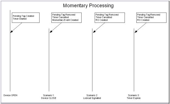

The first figure shows the various scenarios in the momentary processing. The scenarios are:
1. A breaker trips and is followed a short time later by a reclose operation.
2. A breaker trips and is followed by a recloser lockout.
3. A breaker trips but the device has no recloser lockout signal available. FLISR waits a configurable amount of time and, in the absence of a close operation, assumes lockout to have occurred.
Illustration of FLISR scenarios.
Note: RO (Real Outage) is created only if customer supply nodes are de‑energized as a result of the operation.

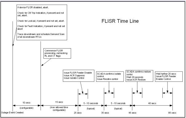

Once an RO is created, the FLISR processing sequence shown in the following figure is initiated.
Illustration of FLISR processing sequence once a real outage has been created.
The control sequence (starting at around 25 seconds) is only performed in automatic mode. In manual mode an operator must initiate the control sequence.
Timings in the above diagram are only indicative. Actual values will depend on the complexity of the solution required and the responsiveness of the isolate/restore controls sent to SCADA. The following timings are deterministic:
• The delay allowed for demand scans. This is configurable and defaults to 10 seconds.
• The maximum solution time allowed in automatic mode. This is configurable and defaults to 15 seconds. If the solution takes longer to solve than this time, FLISR will not automatically execute the control sequence. The option for an operator to manually initiate the control sequence is preserved.
• Maximum time allowed for automatic operations after the lockout is: Demand scan delay + maximum solution time. The default configuration is 25 seconds.
• Wait times for Recloser operations. These are 20 seconds.
• Any error conditions detected during process are logged in the Event Log.
