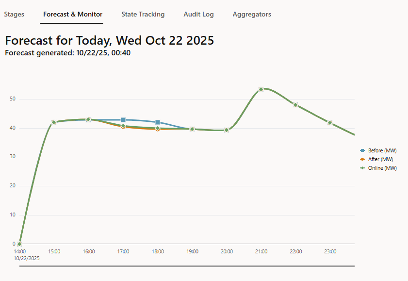

DERMS Strategy/Event Details Forecast & Monitor Tab
The Forecast & Monitor tab displays a graphical representation of the strategy or event. This includes Before, After, and Online lines. And once an event is finished, it also displays an Actual line. By default, this graph starts at 12:00 AM tomorrow (in the user’s time zone), but will start at the next hour if Execute This Event Today is checked.
