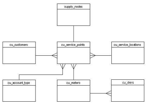

Customer Model - Logical Data Model
This section provides an overview of the logical view of the Oracle Utilities Network Management System customer model. Where the MultiSpeak data model uses Customer, Service Location and Meter entities, the Oracle Utilities Network Management System model adds the notion of a Service Point to increase flexibility, and provide for improved performance of the physical implementation. Additionally, the Oracle Utilities Network Management System model extends beyond the basic MultiSpeak model in the following ways:
• Supports more than one meter per service location.
• MultiSpeak attributes not required for NMS purposes are not required, such as billing information (acRecvBal, acRecvCur, … ) and meterology information (kwh, multiplier, …)
• Provides model extensions to support important attributes not currently defined by MultiSpeak but necessary for NMS purposes.
• Supports customer-defined attributes for read-only purposes with no requirement for use in analysis.
This model, when joined with the Supply Node information in the Oracle Utilities Network Management System database (supply_nodes), results in the following E-R diagram:
Residential Model
In this extended model, it is recognized that the occurrence of multiple meters is reasonably common, where each meter may have different rate codes associated.
Although the occurrence of multiple transformers is much less frequent than multiple meters, there are also several possible configurations of meters and transformers, with different electrical arrangements. Often, multiple transformers will occur on (geographically) large sites (for example, factory, airport, shopping mall, and so forth), where it is appropriate and helpful (from the perspective of outage analysis) to have multiple service locations defined for the site which aid in readily locating the appropriate transformer.
The following pictures depict some simple examples of the usage of this customer model. The first example shows two service locations, each with a meter connected to a distribution transformer.
The second example is an account with a single location with two meters, which is described through the definition of a customer account, a service location and two meters. The service location is associated with a distribution transformer.
A third example would be a combination of the two previous examples, where a single customer account was responsible for the billing related to all of the above service locations. A more sophisticated example of residential metering is provided in the appendix.

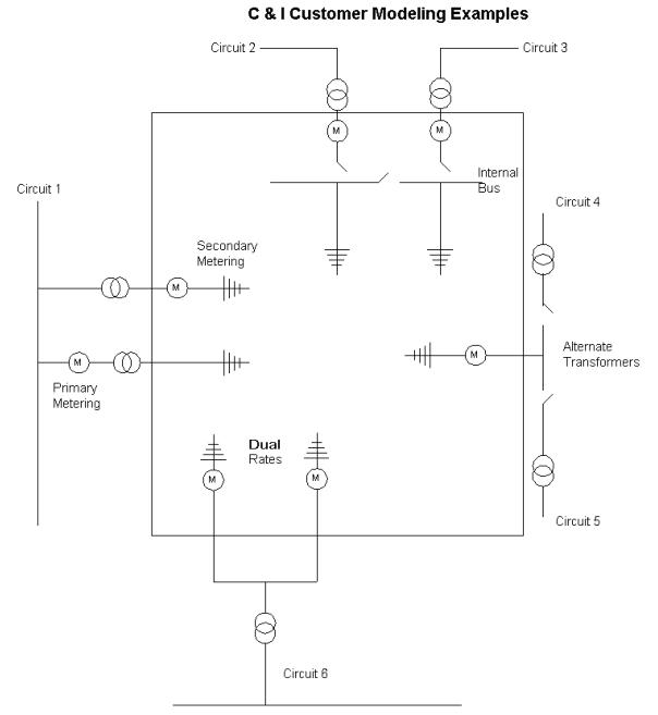

Commercial and Industrial (C & I) Model
Many Commercial and Industrial situations are more complicated than residential metering. In these cases, a variety of configurations of meters, transformers and circuits must be addressed. The variations include:
• Primary metering, where the meter is placed on the high side of the transformer
• Internal buses, where two transformers can be used with two meters, feeding an internal bus
• Alternate transformers, where a meter can be switched to one of two transformers, each on a different circuit
• A single transformer feeding two meters, where different rates apply to each meter
The following diagram illustrates these examples.

Service Points Table
The purpose of the cu_service_points table is to manage the linkages between the cu_customers, cu_service_locations, cu_meters, cu_account_type and supply_nodes tables.
Key indexes are placed on this table for performance. History can be tracked, by setting active_fl to 'N' to identify that a record is now historical. No timestamp is used to track when a service point went out of service and the cu_service_points table is not intended nor recommended as a long term repository for service point history.

Linkages to Other Tables
The customer model has linkages to other tables in the Oracle Utilities Network Management System model. The primary linkage between utility customers and the Oracle Utilities Network Management System electrical network model is the device_id column. The definitive table linkage is between supply_nodes.device_id and cu_service_points.device_id. From the perspective of the cu_service_points table, the device_id field is used to uniquely identify the electrical network model element (supply node) which supplies power to a service point (customer).
In general, an Oracle Utilities Network Management System supply node is any place on the model where a utility customer can be connected to receive electrical power. For customers that wish to model secondary network, this supply point can be associated with a single customer/meter. For customers that are only interested in modeling primary distribution circuits, the supply node is often associated with a secondary transformer.
The Oracle Utilities Network Management System electrical data model is implemented under the assumption that the source for the electrical network model data (generally a Geographic Information System) and the source for the utility customer data (generally a Customer Information System) understand and maintain this customer-to-supply-node relationship. The accuracy of this linkage is critical for reliable trouble call handling and outage reporting. Without this linkage, customer trouble calls enter the system as fuzzy calls and outage reports have diminished accuracy.
