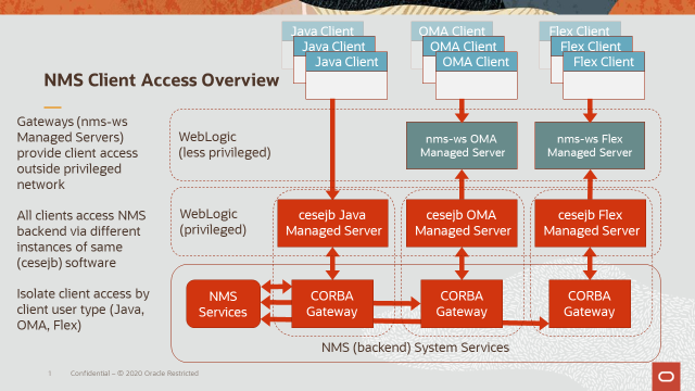

• An example of this type of segmentation is shown in Figure 1 below and is the primary focus of this document.

Figure 1 - NMS Client Access Overview
Note the NMS (backend) System Services tier will always run on the same server - not across multiple servers. This backend tier will either be hosted on a single Symmetrical Multiprocessing (SMP) Unix server such as a single node (at any point in time) of a cluster made up of two or more SMP Unix servers. This tier supports all NMS Services and Gateway related processes shown at the bottom of Figure 1.
The WebLogic tier just above the NMS System Services tier in Figure 1 can run on the same server as NMS System Services or on one or more separate Unix servers. For production NMS instances it is most common for the WebLogic tier to run on separate servers relative to NMS Services.
At least one WebLogic domain is used to authenticate all NMS end users that interface to NMS Services via one or more WebLogic “cesejb” Managed Servers.
In Figure 1, we have three “cesejb” Managed Servers just above the NMS System Services tier (one for NMS Java users, one for NMS Flex users and one for NMS OMA users). These Managed Servers can all be in one WebLogic domain or in separate domains.
By default all WebLogic Managed Servers are in the same WebLogic domain – but as noted above there are other configurations to consider. If multiple WebLogic domains are deployed – the domains must have unique names.
NMS OMA and NMS Flex users have similar authentication options and should be considered equivalent in the discussion below.

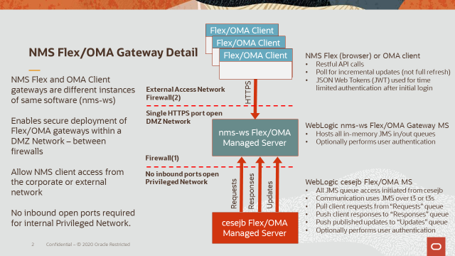

1. OMA/Flex end users can pass authentication requests from their supporting nms-ws OMA/Flex Managed Server down to their supporting cesejb Managed Server for authentication.
a. Can be configured with both the nms-ws OMA/Flex Managed Server and its supporting cesejb Managed Server in the same or different WebLogic domains.
b. Typically deployed with nms-ws and cesebj Managed Servers in a single WebLogic domain.
2. OMA/Flex users can authenticate on their supporting nms-ws OMA/Flex Managed Server.
a. Requires the nms-ws OMA/Flex Managed Server to be in a separate WebLogic domain relative to its supporting cesejb Managed Server.
• The WebLogic domain name for the nms-ws OMA/Flex Managed Server must be different then the WebLogic domain name for the cesejb Managed Server.
b. Requires WebLogic domain “trust” be configured between the two WebLogic domains. This implies a user authenticated via the WebLogic domain supporting the nms-ws OMA/Flex Managed Server is considered authenticated by the WebLogic domain supporting the cesejb Managed Server.
• This “trust” is time limited – often the duration of a typical end user shift.
• Once “trust” expires the end-user will need to re-authenticate.
Figure 2 – NMS Flex/OMA Architectural Deployment Overview
