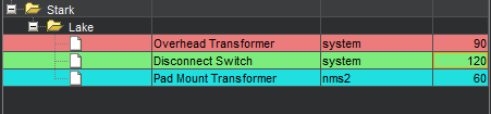

Row Highlighting
The table uses row highlighting to indicate changes that have not been saved. Red indicates that the row is marked for removal, green indicates the row has been edited, and light blue indicates that the row has been added.

7. Click OK. The Device/Zone Default Restoration Times pane refreshes with a new row, which is highlighted in light blue to show the addition.

3. Click anywhere outside the cell to finish the edit. The row will be highlighted in green to indicate the pending change.

2. Click Remove. The row will be marked for removal pending saving changes. The row will be highlighted in red to indicate the pending change.
