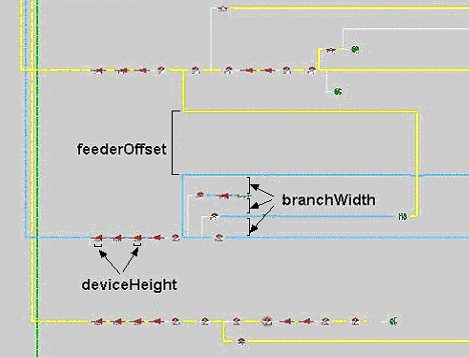

branchWidth <dist> | Distance between two network branches that share a common upstream port. (see Figure 1 below) |

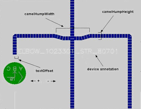

camelHumpHeight | Relative height (in terms of tier-height) of conductor crossover bumps. Value between 1 and 0. (See Figure 4 below) |
camelHumpWidth | Relative width (in terms of branchWidth) of conductor-crossover bumps. Value between 1 and 0. |
deviceHeight <#> | Size of all non-conductor electrical branches. (See figures following this table.) |

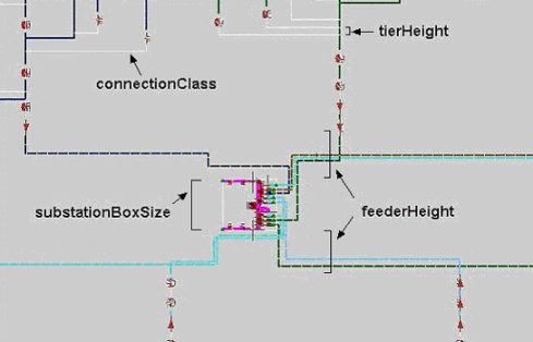

feederHeight <#> | Minimum distance between a substation and the first device of a feeder. (See figures following this table.) |
feederOffset <#> | Distance between adjacent feeders. Default is branchWidth*10. (See figures following this table.) |

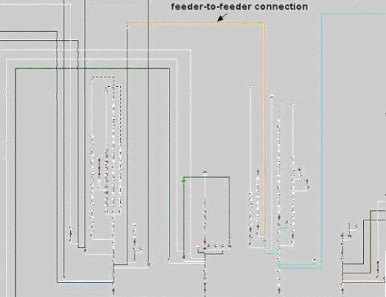

noFeederToFeeder | Do not connect up feeder-to-feeder tie-points. (See figures following this table.) |

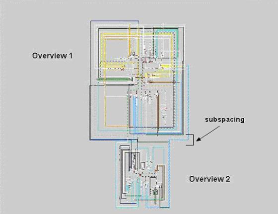

subSpacing <#> | Minimum distance between substations. No default. (See figures following this table.) |
substationBoxSize <#> | Create a square of the specified size and scale the original substation schematic to place inside. Default is 1000. (See figures following this table.) |

textOffset <#> | Distance (along the feeder’s main axis) to pull all device annotation. Default is 0. (See figures following this table.) |
tierHeight <#> | The distance (along the feeder’s axis) a conductor will span. Default is 50. (See figures following this table.) |

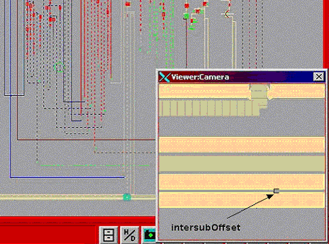

intersubOffset <#> | Minimum distance between parallel sub-to-sub conductors. Defaults to tier-height or deviceheight* 2, whichever is greater. (See figures following this table.) |

connectionClass <class name> | Device class to use when creating a branch to span two or more non-conductor devices. (Must be a nonelectrical branch) |
