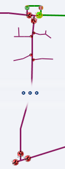

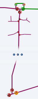

The Viewer's Feeder One Line feature allows you to see one line feeder schematics views.
1. To initiate the feeder one line view, select an object and press 1.
Viewer before initiating feeder one line view.
The Viewer will display the Feeder One Line view.
Viewer in feeder one line view.
Note: Alternatively, you may select Feeder One Line from the Actions menu or click the toolbar button ().

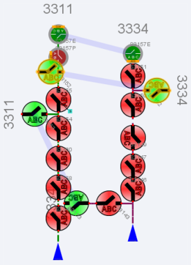

2. To see adjacent feeders in the schematic view, select a tie device in the standard view and press 1.
Viewer with tie switch selected.
The Viewer will display the adjacent feeders schematic with lines highlighted to show the connections.
Viewer showing the adjacent feeder schematics.

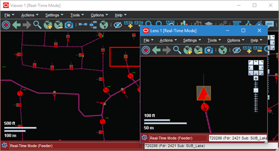

The Viewer's Lens functionality allows you to start a "mini-Viewer" window that is focused and zoomed in on a selected device. To start a Lens window, select a device in the Viewer and select Show Lens from the Viewer's Actions menu. The Lens window will open zoomed in on the device.
Viewer with Lens window.
