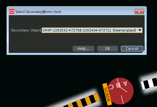

3. Click on the Ground... button and select Place Ground from the drop-down list. The Select Secondary Object dialog box will open.
The Select Secondary dialog box's option list allows you to select a conductor from all conductors attached to the device on the side you want to ground. Once selected, the conductor will be highlighted in the viewer. Screen capture illustrating selecting a secondary option when placing a ground.
4. Select the conductor and click OK.
