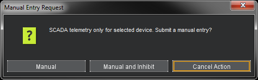

Use the Control Tool to perform operations on SCADA devices in the same manner as you would on non-SCADA devices (see Operating Devices on page 2-107). When you accept the operation in the Look Ahead tool, the system will open the SCADA Manual Entry Request dialog box that allows you to submit a manual entry, submit the manual entry and inhibit further SCADA updates, or cancel the action. If the measurement is already inhibited, the dialog box will offer a Manual and Un-Inhibit option.
Manual Entry Request dialog box with options for a Manual entry, a Manual entry and an Inhibit action, and one to cancel the action.
Note: If the inhibit state is configured for comments, then the Manual and Inhibit option will display a dialog box asking you to enter a comment before you may perform the inhibit action. The comment will be displayed in the SCADA Summary window. For more information, see Adding and Modifying Comments for SCADA Status Changes on page 10-55.
