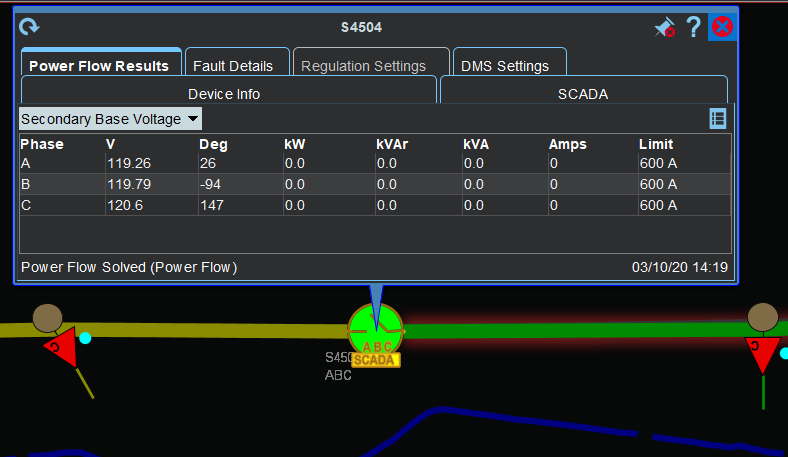

As an object is selected in the Viewer, the Power Flow Results tab updates with the calculated feeder voltages and equipment flows. The lower right corner of the Power Flow Results tab will display the time when the last solution was solved.

4. Select the Power Flow Results tab to display the latest power flow results for the device.
.Screen capture of SCADA device with balloon details showing the Power Flow results tab.
