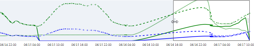

Forecast Accuracy Trend Graph
The Forecast Accuracy trend graph displays a graph of the data for the selected row. The trend graph displays the following data by default:
• Average forecast values for kW and kVAr.
• Actual values seen for kW and kVAr.
• Forecast error for kW and kVAr.
You can use the mouse wheel to zoom in and out. You can also drag the graph to see details over the time line.
You may also widen or shrink the viewport to show more or less detail. Hovering over the viewport left or right side will change the cursor to allow you to resize the box.Screen capture of graph showing resizing the range of dates displayed.
Hovering the mouse over the trend will show the value at the point in the graph.
