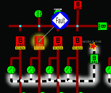

Screen capture of Viewer drawing area showing a Fault event symbol on a breaker.
