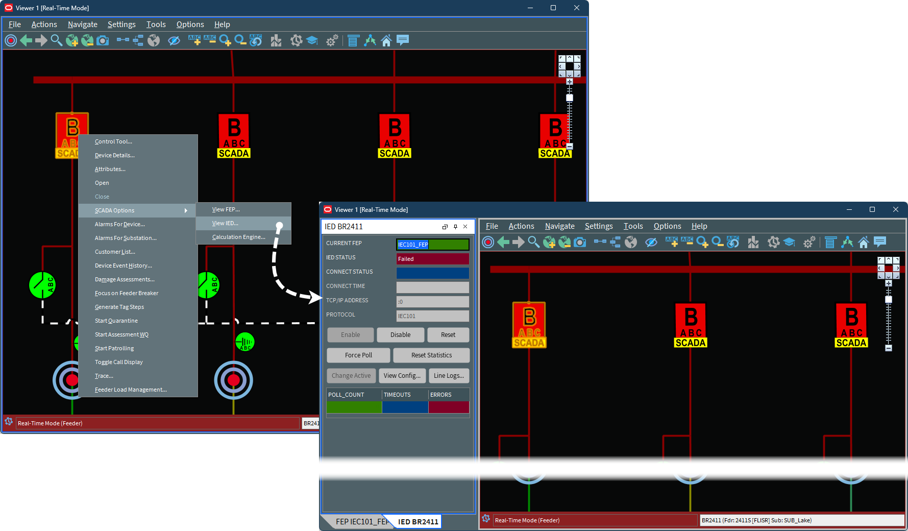

Users that do not have the SCADA maintenance privilege may still want to view and control the state of the IED monitoring a given device. This can be done by selecting a device having valid Flex SCADA connections in the Viewer, then selecting SCADA Options, and then selecting the View IED... command from the context menu.
This will open a dialog box showing the current state of the IED and provide you with the following functionality
• Enable/Disable/Reset the IED.
• Swap the active connection to the IED.
• View the IED diagnostics.
• View and reset IED statistics.
See IED Monitor for information about these options.
