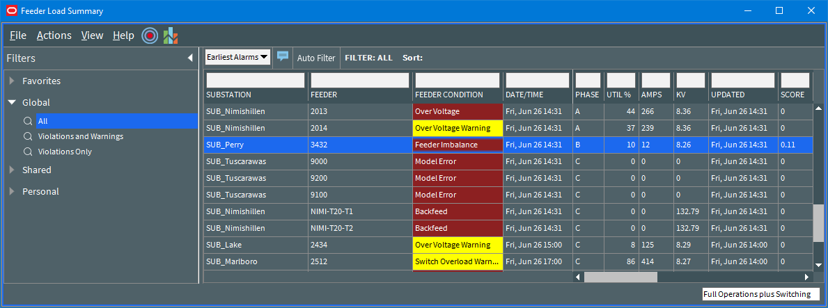

A yellow or red background for a Feeder Condition in Feeder Load Summary or Feeder Load Overview indicates that the feeder head data source and/or quality is abnormal.Screen capture of the Feeder Load Summary window showing abnormal condition coloring in the Feeder Condition column.

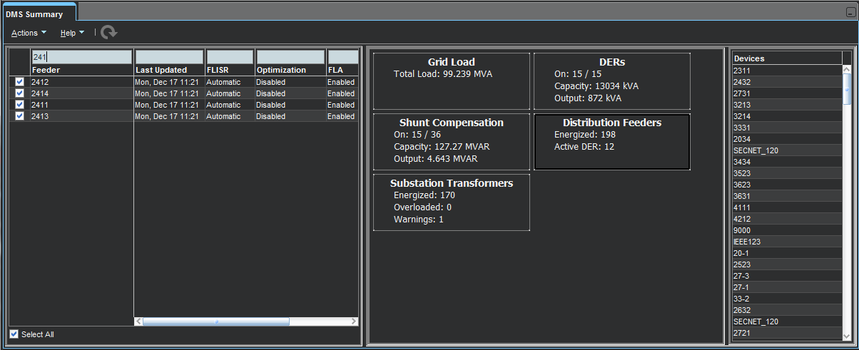

Using the DMS Summary
The DMS Summary displays the summary of the distribution system for FLM-enabled feeders. Screen capture of the DMS Summary filtered to show feeders starting with 241.
The DMS Summary is comprised of three panes:
1. The Feeder pane (left) displays a table with the FLM-enabled feeders in the subscribed zone. The filter box allows you to filter the list to quickly find a feeder of interest. The checkbox allows you to select or deselect all feeders. The table provides the following columns:
Feeder
Last Updated
PF Mode (hidden by default)
FLISR
FLM (hidden by default)
Optimization
FLA
Optimization Objective
Protection Scheme
Protection Scheme Mode
Feeder Type (hidden by default)
PF History (hidden by default)
Note: See Understanding Column Display Options for information on unhiding and hiding table columns.
2. The middle pane displays the status of Grid Load, DERs, Distribution Feeders, Shunt Compensation, and Substation Transformers.
3. The Devices pane (right) displays a list of devices providing data for the block selected in the middle pane.
When there is an update available from FLM, the Refresh button () will be enabled; click the Refresh button to update the DMS Summary data.
If you select a device listed in either the left pane or right pane and right-click, you can select View... to focus the device in the Viewer.
