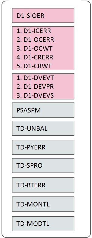

The Ongoing or Hourly Processes
The following diagram illustrates the dependencies between the ongoing or hourly batch processes.
The mnemonics in the boxes refer to the individual batch processes described above. When a box contains multiple processes, these processes must be run sequentially.
No dependencies exist. As you can see, there are no dependencies between the boxes (meaning they may be run in parallel).
