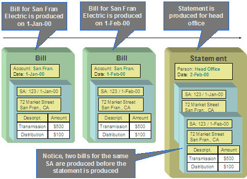

◦ All "SA snapshots" associated with bills whose BILL DATE is within the construct detail's start and end dates that are not already linked to one of the construct's statements are linked to the new statement. Note, an "SA snapshot" is created for every service agreement linked to an account when a bill is completed for an account.

The following diagram illustrates how the above logic could result in multiple bills for a single service agreement being linked to the same statement.
