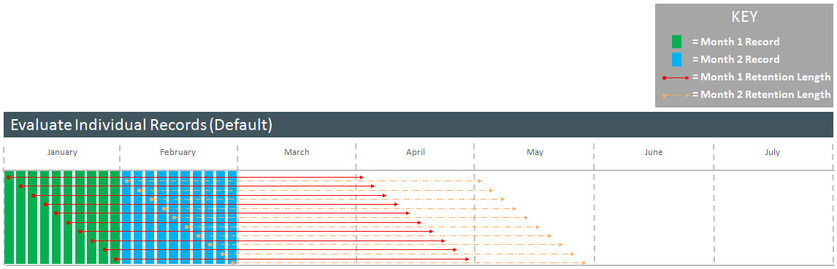

• Evaluate Individual Records:
• This is our default approach
• This is the standard approach to evaluating ILM retention for all maintenance objects with a single retention period
• The ILM date for each record will be compared against the current date less the retention period for that type of record. Simply stated, any records older than the retention period will be evaluated for eligibility.
• In this option we will process a portion of a partition each day and only once we had processed the entire partition would the DBA be able to take an archiving action on the partition
• This results in many visits to the partition to determine eligibility
• The image below illustrates how the evaluate individual records method will crawl one day of records on a partition and sub-partition each day until the retention period for the last day of the partition had expired. All records would then be archived together when the last day of the partition was marked as eligible. This results in daily processing of small amounts of records but frequent visits to the partition.

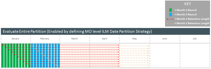

• Evaluate the Entire Partition
• This option will be enabled by configuring the ILM Date Partition Months in the maintenance object options
• In this option all records on a ILM date partition retention period sub-partition will be evaluated at the same time.
• For example, for a monthly partitioning strategy in the month of January we would not evaluate any records in the January partition until January 31st had reached the end of its retention period.
• This means that we would evaluate the 1st through the 31st all at one time
• This option should typically result in a single visit to the partition to determine eligibility
• The image below illustrates how the evaluate entire partition method will only crawl records from a given partition and sub-partition when all records on that partition are eligible to be evaluated. Therefore, when the last day of the partition is ready to be evaluated the entire partition will be evaluated. This results in periodic processing with, and in many cases, a single visit to the partition for ILM purposes.
