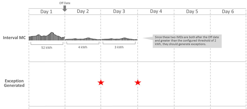

Example 1: Non-zero data during disconnected period
Example Scenarios

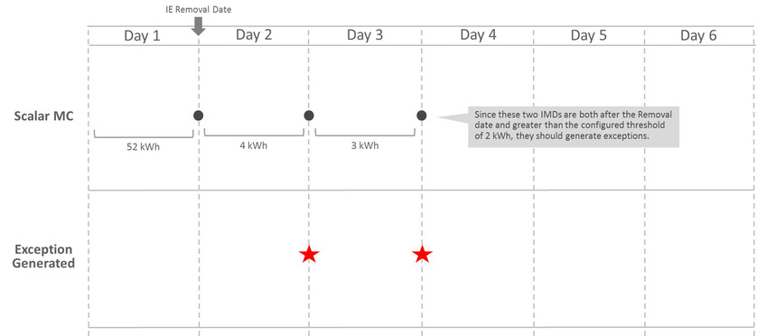

Example 2: Non-zero data after removal date with no new install
Example Scenarios

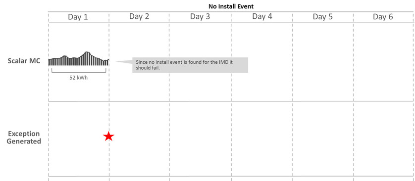

Example 3: Data received when device has no Install Event records
Example Scenarios

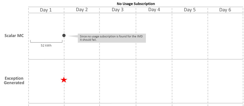

Example 4: Data received when not connected to a Usage Subscription record
Example Scenarios
