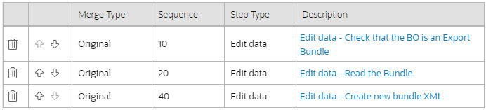

Removing a Step from Script
If you want to remove a record linked to the Original script, click the delete button to the left of the record.
For example, to remove the Reset existing bundle XML step, click the Delete icon icon.
Removing "Reset existing bundle XML" step.
After removal, the grid displays:
Grid after step removal
You cannot delete a step that is referenced by other steps unless you also delete the referencing steps, such as Go to step or Prompt type steps. The system informs you of any missing referenced steps when you attempt to save the original script.

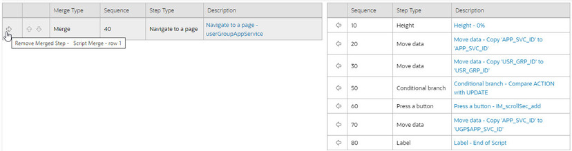

You can move any of the steps from the Merge From script to the Original Script by clicking the left arrow adjacent to the desired step. Once a record is moved it disappears from the Merge From information and appears in the Original information with the word Merge in the Merge Type column.
For example, to copy the Navigate to a page step, click the left arrow.
Example: Copying the Navigate to a Pager step
The step is moved to the left portion of the page.
Example: Moving the Navigate to a Pager step
If you add a step, such as Go to step or Prompt type steps, that references other steps, you must also add the referenced steps. The step references are updated to use the new sequence numbers when you save the original script. The system informs you of any referenced steps that haven't been added when you attempt to save the original script.
Removing an Uncommitted Step from a Script
Use right arrow to remove a script row
