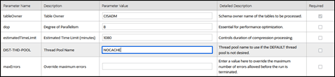

• ILM Automation - Measurement Compression (K1-ILMMC): This process changes the compression level from Advanced to Hybrid Columnar for Measurement data that is at least two months old which results in significant disk space saving. This compression job reorganizes the data and improves query performance. Parameters used by this process include: Table Owner, Degree of Parallelism, and Estimated Time Limit. This batch control should be part of monthly batch job streams so that its run once per month and during off peak / non-critical hours.
K1-ILMMC Sample Parameters:
F1-ILMMC Parameters
Note: This batch job should be run with DIST-THD-POOL batch parameter with value of NOCACHE and during off peak hours.
• ILM Automation - Non-Measurement Compression (K1-ILMNC): This process changes the compression level from Advanced to Hybrid Columnar for non-Measurement partitions at least two months old and results in significant disk space savings. Parameters used by this process include: Table Owner, Maintenance Object Codes (used to define specific maintenance objects for compression), Degree of Parallelism, and Estimated Time Limit. This batch control should be part of monthly batch job streams so that its run once per month and during off peak / non-critical hours.
If the K1-ILMNC batch process is submitted without the maintenance object parameter defined, it compresses all maintenance objects except D1-IMD. In order to compress D1-IMD, submit a separate batch job and specify D1-IMD as the Maintenance Object parameter.
K1-ILMNC Sample Parameters:
F1-ILMNC Parameters

F1-ILMIN Sample Parameters:
F1-ILMIN Parameters
