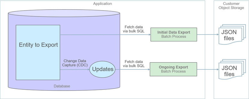

The generalized data export method provides a file-based export of data in JSON format. Exporting the data of a maintenance object using this method involves an initial export of the entity’s entire data followed by an ongoing export of changes as they are made over time. These processes are illustrated in the following diagram:
The overall process involves the following steps:
• Enable entities for export in the
Generalized Export Dashboard portal. You may enable many entities at once. This step also allows you to enable ongoing export of these entities.
• Submit the Generalized Initial Export Initiator (F1-GEXPI ) batch process to export the current content of all enabled entities. This step submits a separate batch process for each entity you have enabled for export.
• Schedule the Generalized Ongoing Export (F1-GEEXO ) batch process to run periodically.
The following sections further discusses concepts and guidelines related to the generalized data export method.

When applicable, ongoing data export should be enabled before submitting the initial export batch process for the entity. This ensures that changes made during the initial export are properly tracked.
Initial Data Export
Each maintenance object that is eligible for the generalized data export method is associated with an initial data export batch control that is referenced on the maintenance object using the Export Batch Control option. The same common batch program is used by all these batch controls to export the entire data of an entity to files. The process is multi-threaded and produces one file per thread by default. An optional batch parameter allows for multiple smaller files to be generated per thread by setting a limit on the number of records written to each file. Refer to the File Size section for more information.
Instead of manually submitting the generalized initial export batch process for each maintenance object you have enabled for export, submit the F1-GEXPI Generalized Initial Export Initiator batch process to automatically submit them all at once.
The initial export process for each maintenance object updates the corresponding data export control record for the maintenance object to indicate that the process has started and updates it again upon completion. This allows you to view the overall status of the initial export across all enabled entities on the
Note that the initiator batch process only submits batch processes for enabled maintenance objects that according to their data export control record their initial export has not started yet. If you need to export one or more entities again, reset the initial export status indication on their data export control records and submit the initiator batch process again.

Ongoing Data Export
Data changes are tracked by the Capture Change for Ongoing Export (F1-MO-REGCHN) Maintenance Object Audit algorithm. The algorithm records the prime key of a changed entity in a designated Data Export Update table that serves as a queue of changed entities to export. The queue is later on consumed by the ongoing data export batch process.
The Maintenance Object Audit plug-in spot is capable of tracking changes made to the entity by any layer of the application. Making changes using direct SQL would bypass this mechanism and therefore should be avoided.
The audit rule is added to a maintenance object when the ongoing data export option on its corresponding data export control record is enabled. In the same way the audit rule is removed from the maintenance object when the ongoing export option is disabled.
The ongoing export option has to be enabled on the data export control record for the entity before it is initially exported. This ensures changes made while the initial export process is in progress are not missed.
Unlike the initial export batch process that requires a batch control to be defined for each eligible maintenance object, a single batch process is used to export ongoing changes made to all entities.
The following describes the ongoing export batch process at a high level:
• All changes queued in the Data Export Update table are exported to a designated ongoing export file. Refer to the Managing a Large Backlog section for more information.
• A full snapshot of the data related to the changed entity is exported to avoid heavy data merging on the target side.
• Once exported, records are deleted from the Data Export Update table.
The process is multi-threaded and a separate file is produced for each thread by default. An optional batch parameter allows for multiple smaller files to be generated per thread by setting a limit on the number of records written to each file. Refer to the File Size section for more information.
