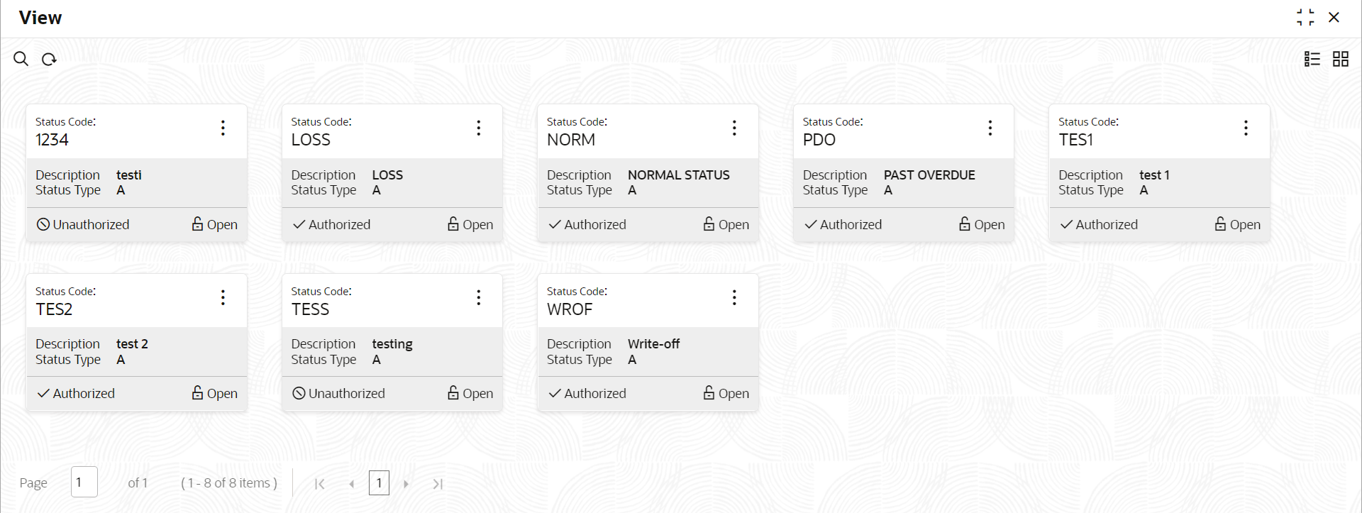

    Figure 1-40 View Status Code
    View Status Code
    For more information on fields, refer to the field description table below.
    Table 1-43 View Status Code - Field Description
    Field Description
    Status Code Displays the Status Code.
    Description Displays the description of the Status Code.
    Status Type Displays the Status Type A.
    Status Displays the status of the record.
