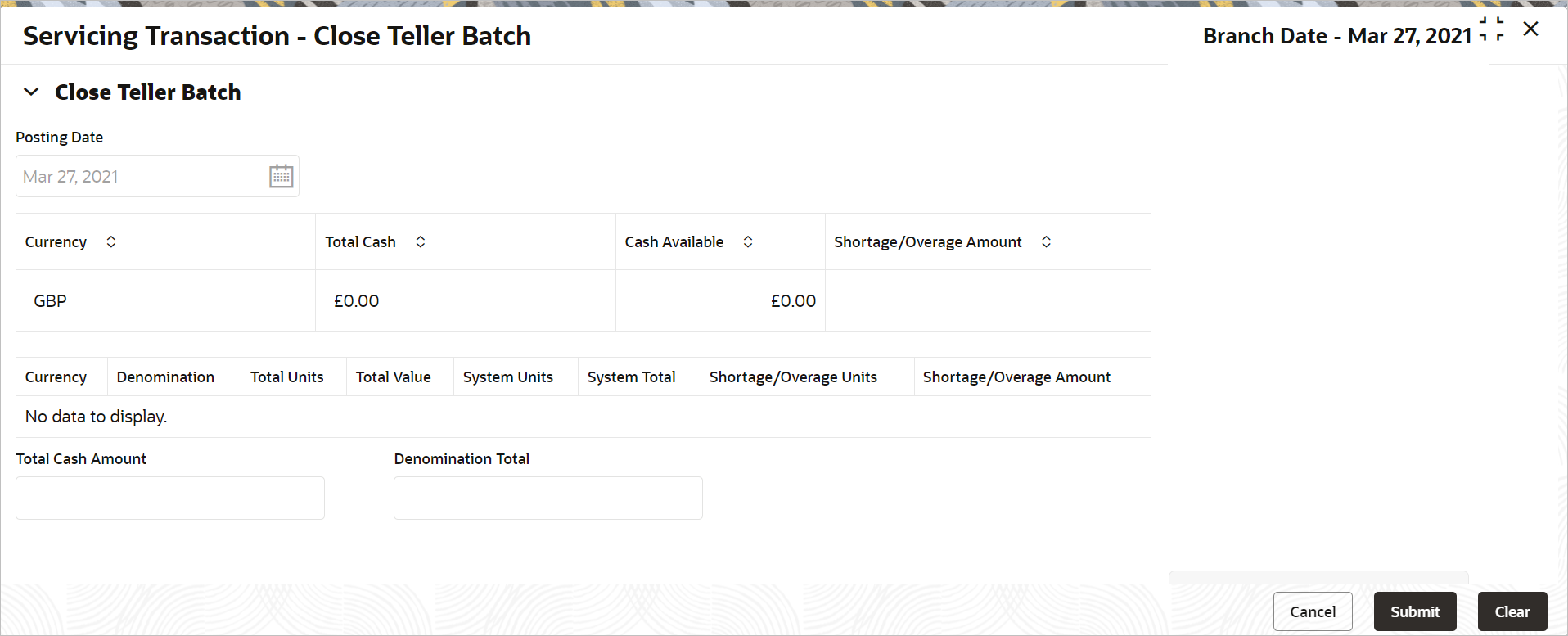

To close the teller batch:
  1. On the Home screen, from Teller mega menu, under Branch Operations, click Close Teller Batch or specify Close Teller Batch in the search icon bar and select the screen.
    The Close Teller Batch screen is displayed.
  2. On the Close Teller Batch screen, specify the details. For more information on fields, refer to the field description table.

  3. Click Submit.
    The cash balance is updated, and the teller batch is closed for the posting date.
    If there is any overage or shortage, the system displays an error message stating that the cash is not balanced for the Teller ID. Also, if any of the conditions mentioned above fail, the system displays an appropriate error message on submit.
