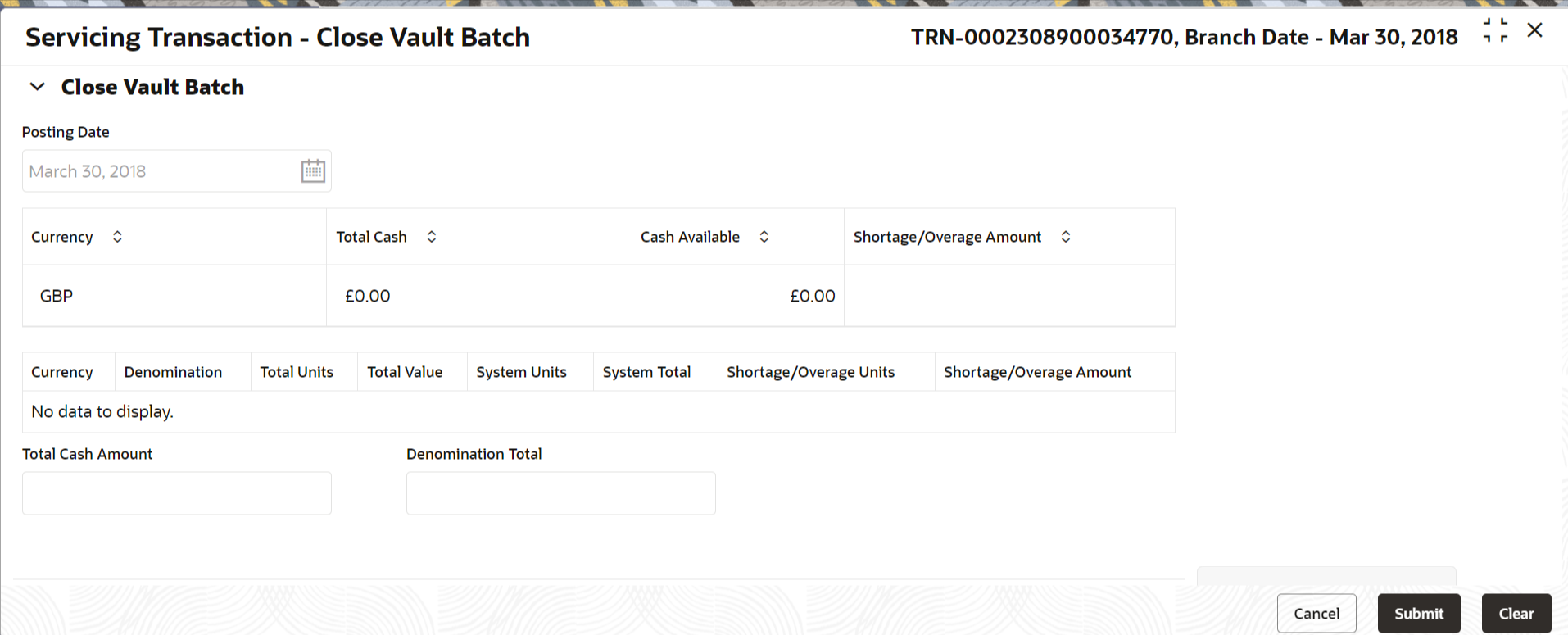

  1. On the Home screen, from Teller mega menu, under Branch Operations, click Close Vault Batch or specify Close Vault Batch in the search icon bar and select the screen.
    The Close Vault Batch screen is displayed.
  2. On the Close Vault Batch screen, specify the fields. For more information on fields, refer to the field description table.

  3. Click Submit.
    The cash balance is updated and the vault batch is closed for the posting date.
    During vault batch closure, the system will internally transfer the closing balance from the current open Vault ID to the Primary vault of the branch. If there is any overage or shortage, the system displays an error message stating that the cash is not balanced for the Teller ID. Also, if any of the conditions mentioned above fail, the system displays an appropriate error on submit.
