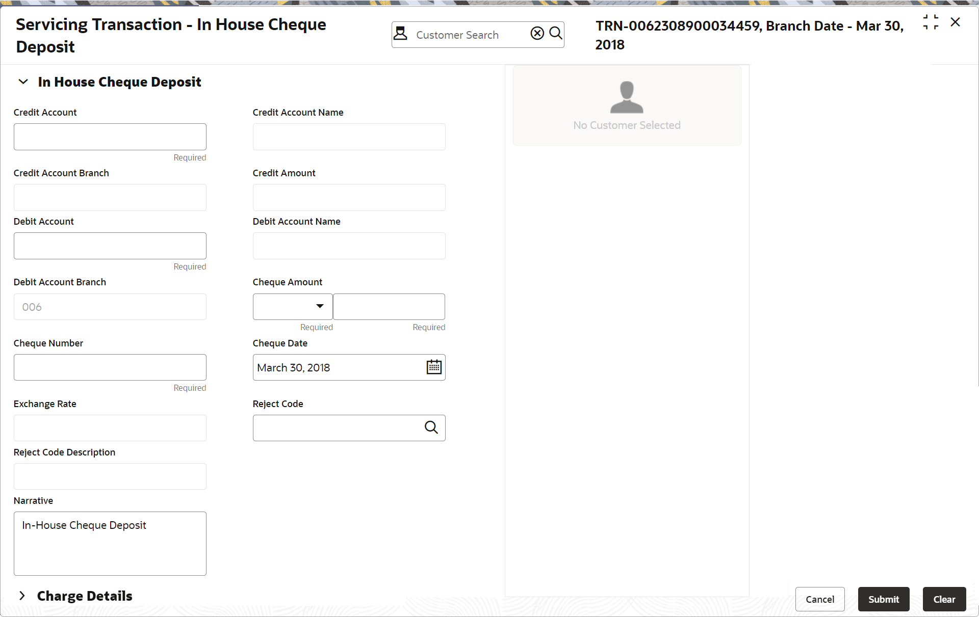

To capture in-house cheque deposit transactions:
  1. On the Home screen, from Teller mega menu, under Transfers, click In House Cheque Deposit or specify In House Cheque Deposit in the search icon bar and select the screen.
    The In House Cheque Deposit screen is displayed.
    Figure 3-1 In House Cheque Deposit
  2. On the In House Cheque Deposit screen, specify the fields. For more information on fields, refer to the field description table.

  3. Specify the charge details. For information on the fields in the Charge Details segment, refer to Charge Details.
  4. Click Submit.
    A teller sequence number is generated, and the Transaction Completed Successfully information message is displayed.
    The transaction is moved to authorization in case of any warning raised when the transaction saves.
    When you submit, the transaction details are handed off to accounting.
