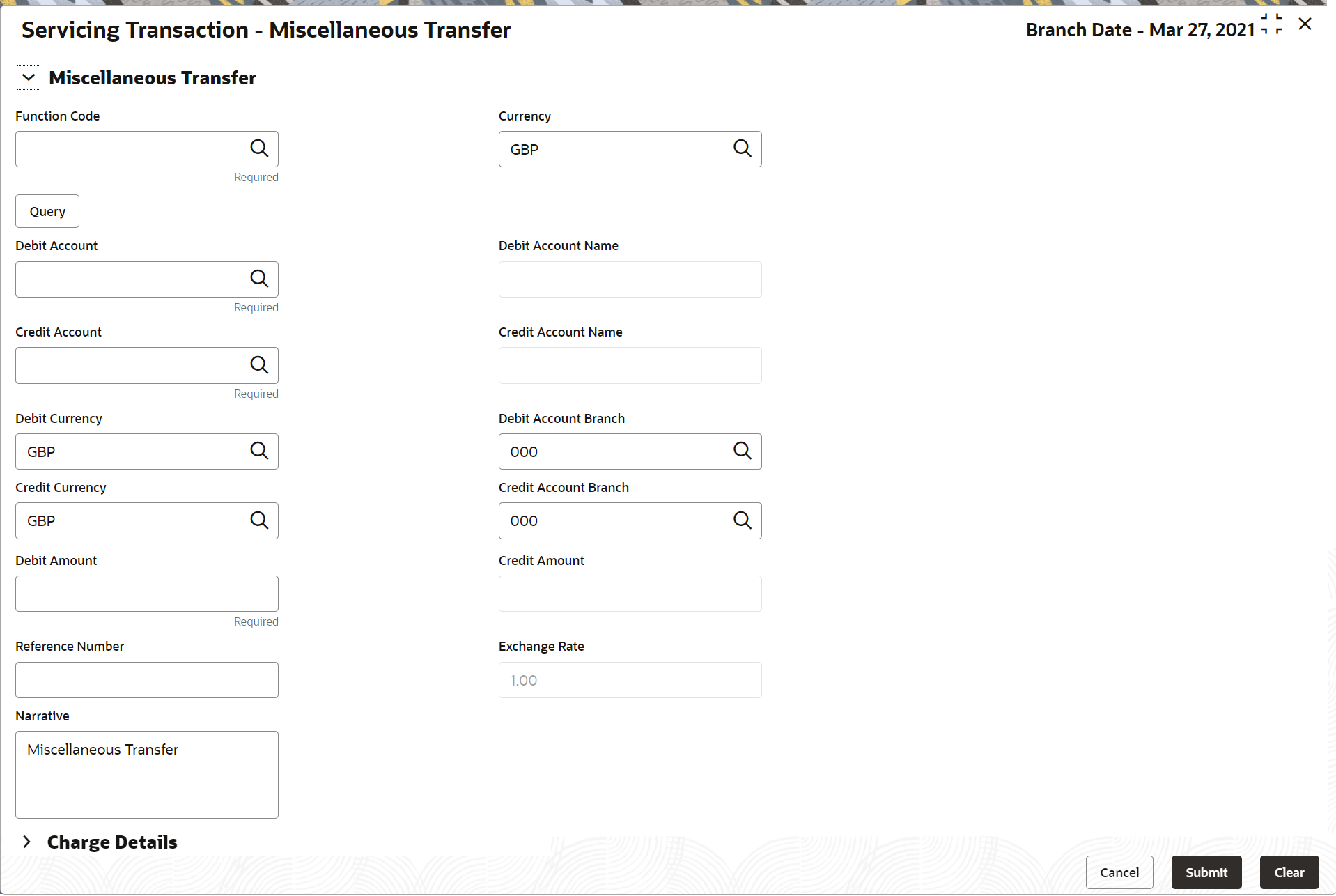

To perform miscellaneous transfer:
  1. On the Home screen, from Teller mega menu, under Miscellaneous, click Miscellaneous Transfer or specify Miscellaneous Transfer in the search icon bar and select the screen.
    The Miscellaneous Transfer screen is displayed.
    Figure 6-1 Miscellaneous Transfer
  2. On the Miscellaneous Transfer screen, specify the fields. For more information on fields, refer to the field description table.

    Displays the default narrative as Miscellaneous Transfer, and it can be modified.
  3. Specify the charge details. For information on the fields in the Charge Details segment, refer to Charge Details.
  4. Click Submit.
    A teller sequence number is generated, and the Transaction Completed Successfully information message is displayed.
