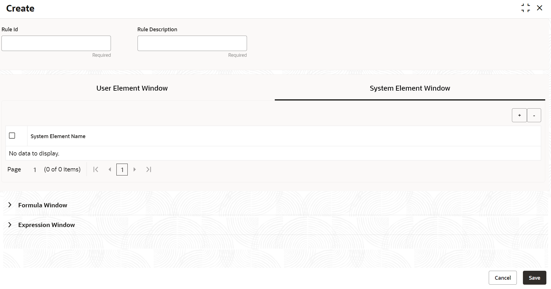

  4. Click System Element Window to update the system element details.
    The System Element Window displays.
    Figure 7-2 Create Interest Rule_System Element Window
    Table 7-2 System Element Window - Field Description
    Field Description
    System Element Name Click Search icon and select the system element name from the drop-down list.
    The user must specify the method for calculating interest in the form of formulae.
    Formula Window:
    Using the SDEs and the UDEs specified for a Rule, the user can calculate interest. The user must specify the method for calculating interest in the form of formulae. Using the SDEs and the UDEs, the user can create any number of formulae for a rule.

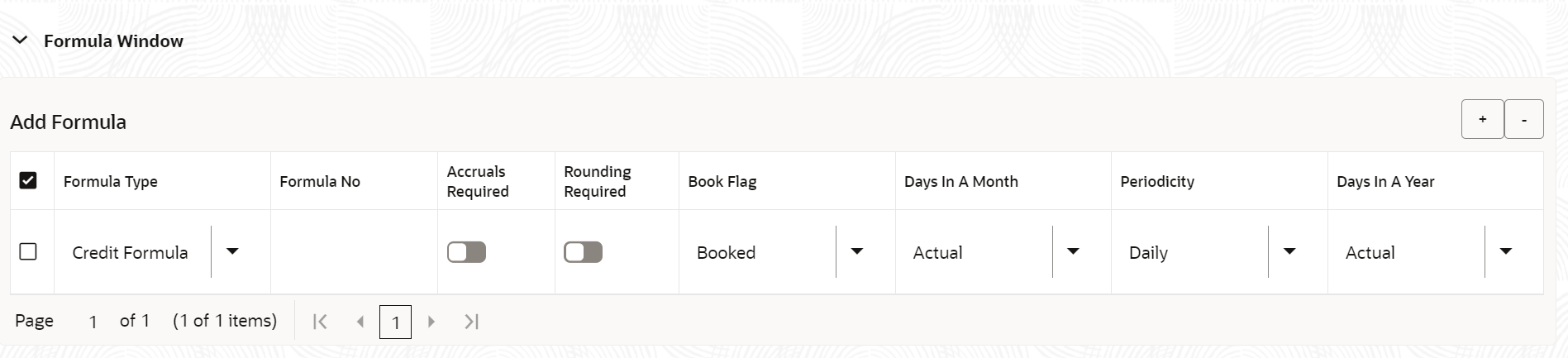

  5. Click Formula Window button to invoke the formula section.
    The Formula Window screen displays.
    Figure 7-3 Create Interest Rule_Formula Window
    Table 7-3 Formula Window - Field Description
    Field Description
    Formula Type Select the formula type from the drop-down list.
    You must specify the method for calculating interest in the form of formulae.
    Formula No Specify the formula number.
    Formula Number Using the SDEs and the UDEs that you have specified for a Rule, you can calculate interest. Using the SDEs and the UDEs you can create any number of formulae for a Rule.
    Accruals Required Select the toggle to enable the interest accruals.
    Rounding Required Select the toggle to enable the interest rounding.
    Book Flag
    The Booking Flag of a formula denotes whether the result of a formula should be:
    • Booked - If the resulting amount should be posted to the customer account.
    • Unbooked - The result of the formula is to be used in another formula and not to be posted to the customer account.
    • Tax - The formula is used to calculate tax. The tax can be borne either by the customer or the bank.
    Days In A Month
    The method in which the N of the formula for interest calculation, PNR/100, has to be picked up is specified for a formula. This is done through two fields:
    • Days in a month
    • Days in a year
    The number of interest days for an account can be arrived at in three ways.
    • By considering the actual number of days in a month
    • By the US method of considering 360 days in a year 3-8
    • By the Euro method of considering 360 days in a year
    Periodicity
    The Periodicity of a rule application denotes whether the formula you are defining has to be:
    • applied for each change during the interest period (or daily).
    • only for the last day of interest period (periodic).
    Days In A Year
    The interest rate is always taken to be quoted per annum. You must therefore indicate the denominator value (the total number of days in the year) based on which interest has to be applied. You can specify the days in a year as
    • Actual number of days (leap year will be 366, non-leap year will be 365)
    • 360 days
    • 365 days (leap and non-leap will be 365)

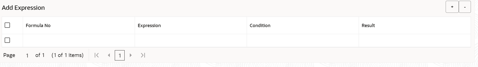

    Expression Window
  6. Click Expression Window button to invoke Add Expression table grid.
    The Expression Window displays.
    Figure 7-4 Create Interest Rule - Expression Window
    Table 7-4 Expression Window - Field Description
    Field Description
    Expression Specify the expression.
    Condition Specify the condition.
    Result Specify the result.
    Debit/Credit
    The result of a formula will be an amount that has to be either debited from the customer account or credited to it.
    For example, the debit interest that the user charge on an overdraft would be debited from the customer account; while the credit interest that the user pay would be credited to the customer account. In this screen, you indicate this. Often, when calculating interest for an account, the user would want to debit interest under certain conditions and, under certain other conditions, credit interest. In such a case, the user can build formulae to suit both conditions. The formula that is used to calculate interest for the account would depend on the condition that is fulfilled.
