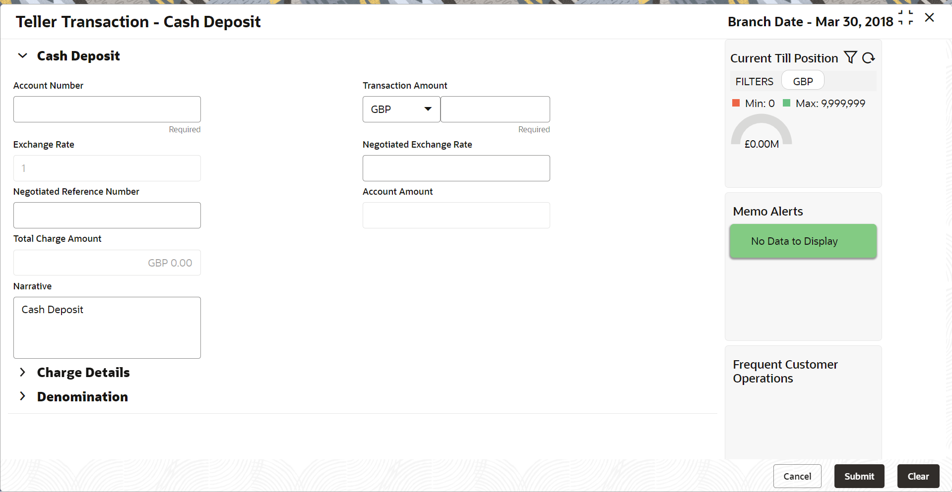

The Cash Deposit screen is used to deposit the cash in a CASA. Cash can be deposited in either account currency or any foreign currency that is allowed.
Whenever any transaction in foreign currency is posted to the account, it is converted to the account currency based on the maintained exchange rate for the transaction.
To deposit cash:
- On the Home screen, click Teller. On the Teller Mega Menu, under Customer Transaction, click Cash Deposit or specify the Cash Deposit in the search icon bar.The Cash Deposit screen is displayed.
- On the Cash Deposit screen, specify the fields. For more information on fields, refer to the field description
table.
Table 5-1 Cash Deposit - Field Description
Field Description Account Number Specify a valid account number for the customer. When you press the Tab key, the corresponding account information will be displayed in the Customer Information widget. Note:
The system displays an override or error message on the tab out of Account Number based on the account dormancy parameters.Transaction Amount Displays the local currency of the branch. You can also select other transaction currencies from the drop-down values.
Specify the transaction amount that needs to be credited to the customer account.
Exchange Rate Displays the exchange rate used to convert the transaction currency into account currency and it can be modified.Note:
If the transaction currency is the same as the account currency, the system displays the exchange rate as 1. This field is displayed only ifMulti-Currency Configurationat Function Code Indicator level is set as Y.Negotiated Exchange Rate Specify the negotiated exchange rate that should be used for foreign currency transactions between the treasury and the branch. You need to specify the negotiated exchange rate only when the currencies involved in the transaction are different.Note:
This field is applicable only if the transaction involves cross currency and only if cross currency enabled andNegotiated_Rate_Enabled Configurationat Function Code Indicator level is set as Y.Negotiated Reference Number Specify the unique reference number that should be used for negotiation of cost rate, in foreign currency transaction. If you have specified the negotiated cost rate, then you need to specify the negotiated reference number also.
Account Amount Displays the transaction amount converted in terms of account amount based on the exchange rate.Note:
This field is displayed only ifMulti-Currency Configurationat Function Code Indicator level is set as Y.Total Charge Amount Displays the total charge amount, which is computed by the system in the local currency of the branch.Note:
This field is displayed only ifTotal Charges Configurationat Function Code Indicator level is set as Y.Narrative Displays the default narrative as Cash Deposit, and it can be modified. - Specify the charge details. For information on the fields in the Charge Details segment, refer to Charge Details.
- Specify the denomination details. For information on the fields in the Denomination Details segment, refer to Add Denomination Details.
- Click Submit.
