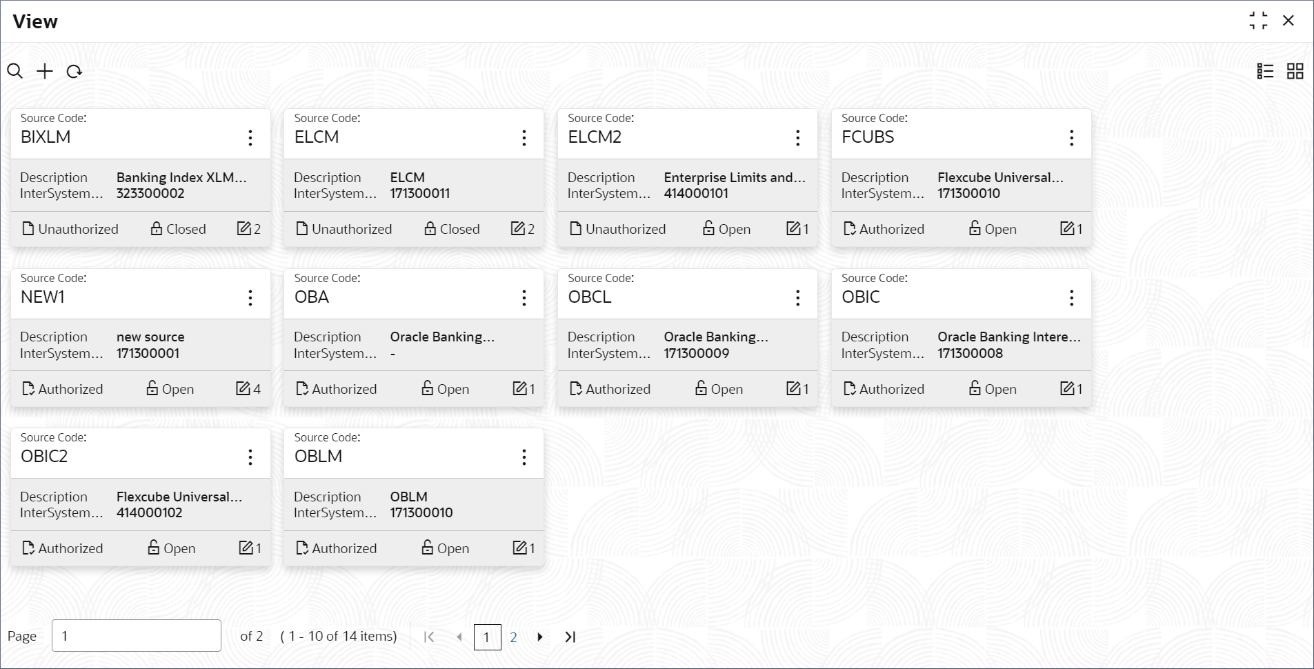

  1. Click Account Configurations, and under Account Configurations, click Source Code.
  2. Under Source Code, click View.
    The View page displays.
    Tip:
    Click Tile view or List view to switch between the Tile view and the List view.
    Table 3-2 Source Code Tile - Field Description
    Field Description
    Source Code Displays the Source Code.
    Description Displays the description of the source code.
    InterSystem Bridge GL Displays the Internal GL as an inter-system bridge GL for the source code.
    Authorization Displays the authorization status of the record.
    • Authorized
    • Rejected
    • Unauthorized
    Status Displays the status of the record.
    • Open
    • Closed
    The following table describes the action items in the More Options (More Options menu icon) menu and the action items on the page.
    Table 3-3 Action Items Description
    Action Item Description
    Unlock Unlock a record and make amendments.
    Close Close a record to prevent it from being unlocked and amended.
    View View the details of a record.
    Delete Delete a record.
    Once deleted, the component can no longer be used to define an entity. But entities already defined using the component can continue to use it.
    Reopen Reopen a closed record.
    Authorize Authorize a record to make it active and available to define entities.
    Creator of a record cannot authorize the component. Another user with authorize permissions can.
    Audit Select to view the Maker, Checker, Status, and Modification Number of a record.
    Errors and Overrides Select to view all existing errors or warnings on the page.
    The actions you can perform depend on your role and the record status.

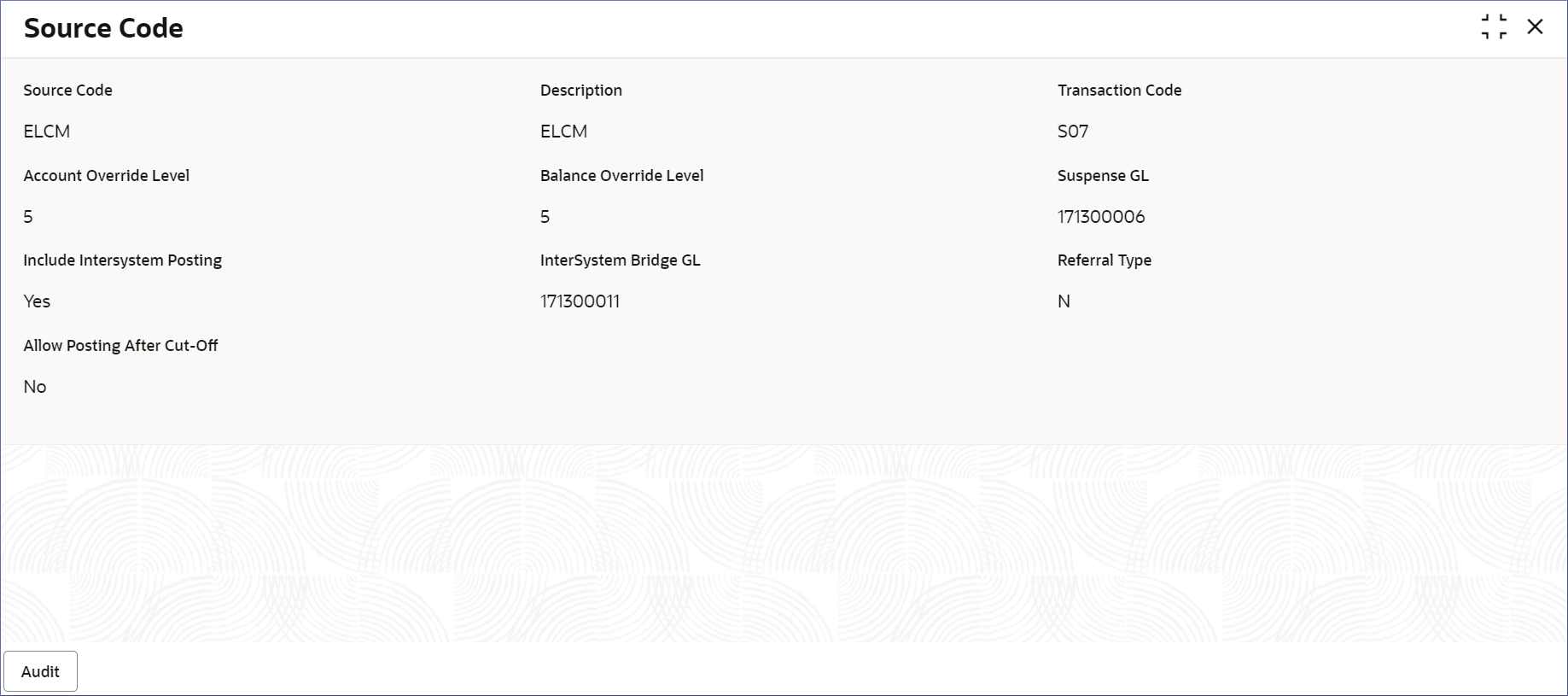

  3. View the details of a Source Code tile.
    1. Click More Options menu icon and select View.
      The Source Code page displays.
      Figure 3-3 Source Code Details View
    2. Click Audit.
      A dialog displays the Maker, Checker, Status, and Modification Number.

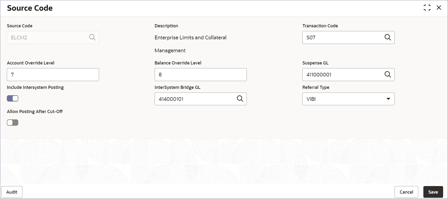

  4. Unlock and update a Source Code.
    1. Click More Options menu icon and select Unlock.
      Figure 3-4 Source Code - Unlock
      The fields that are grayed out cannot be updated.
    2. Edit the required fields.
      For more information on editing the Source Code, see Configure Source Code.
    3. Click Save.
