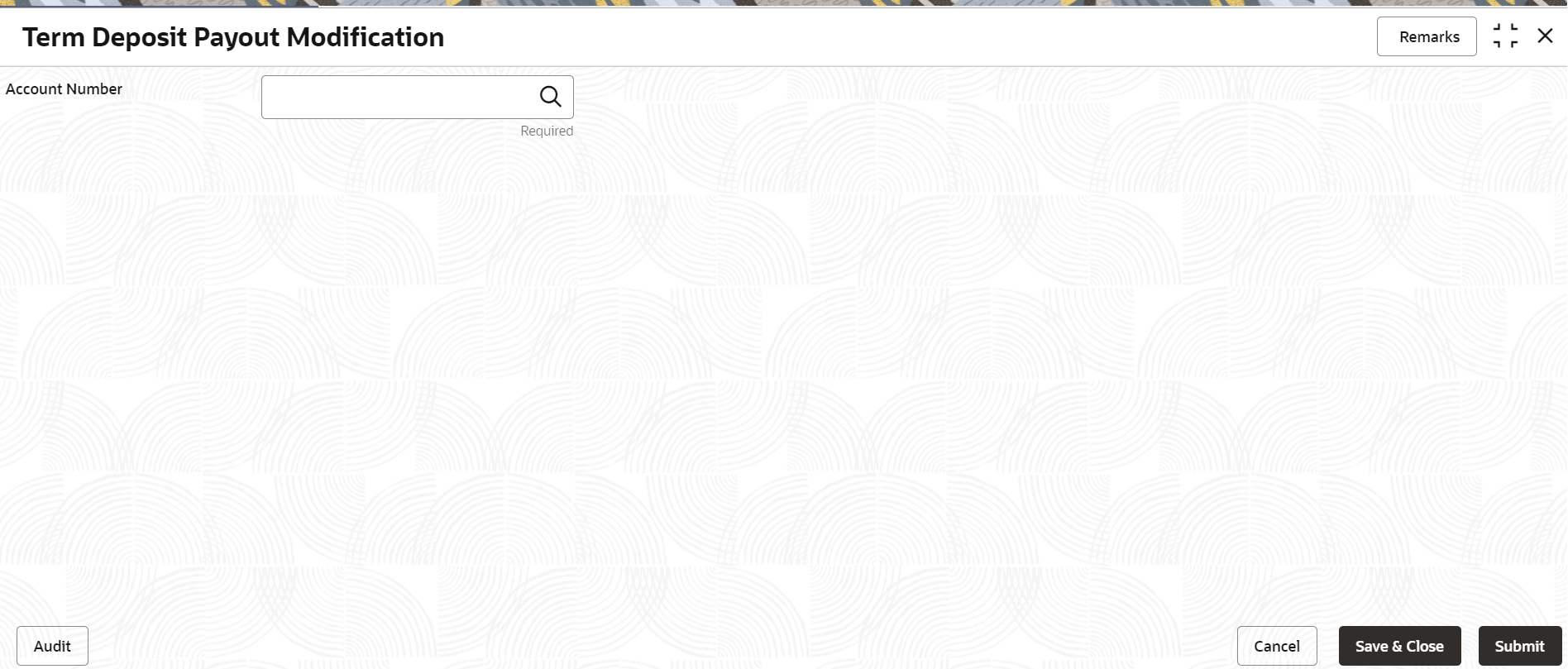

The Term Deposit Payout Modification screen is displayed.
Figure 2-37 Term Deposit Payout Modification

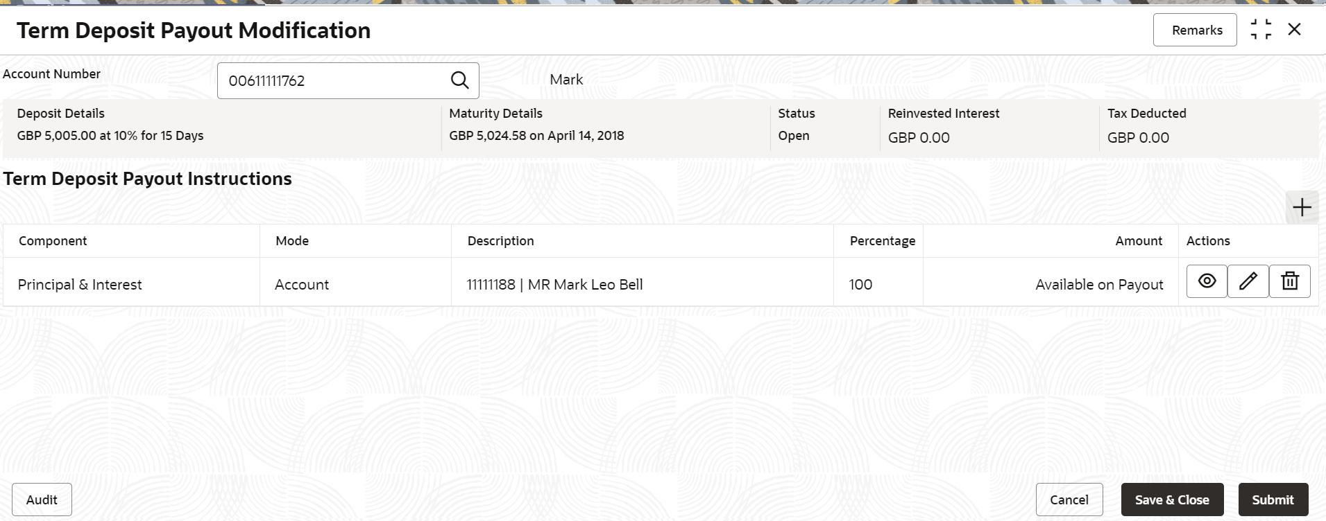

Description of "Figure 2-37 Term Deposit Payout Modification" - On the Term Deposit Payout Modification screen, click
the Search icon or specify the account number in the
Account Number field.The details are displayed.
Figure 2-38 TD Payout Modification Details
Description of "Figure 2-38 TD Payout Modification Details" - You can view the payout details of the TD account. For more information on fields, refer to the field description
table.
Table 2-30 View TD Payout Details – Field Description
Field Description Account Number
Click the Search icon and select the account number or specify the account number to modify the TD payout.Note:
The account holder name is displayed adjacent to this field.Deposit Details
Displays the principal balance, the rate of interest, and the tenor of the TD account.
Maturity Details
Displays the amount due to the customer on maturity and the maturity date.
Status
Displays the status of the TD account. The possible options are:- Active
- Overdue
- Closed
Reinvested Interest or Interest Paid
Displays the amount and currency for the reinvested or paid out interest. Note:
- If the interest if of reinvest type, then the field name is displayed as Reinvested Interest.
- If the interest if of paid out type, then the field name is displayed as Interest Paid.
Tax Deducted
Displays the tax amount deducted till date.
Term Deposit Payout Instructions
This section displays the existing payout instructions of the TD account.
Component
Displays the component of payout. The possible options are:- Principal
- Interest
- Principal & Interest
- Rollover Principal
- Rollover Interest
- Rollover Principal & Interest
Mode
Displays the mode of payout. The possible options are:- Account
- Ledger
Description Displays a brief description of the payout.
Based on the payout mode, the description is displayed. The description according to the mode are as follows:- Account – Account Number & Account Name
- Ledger – Ledger Code, Ledger Name
Percentage Displays the percentage of payout.
Amount Displays the TD payout amount.
For Interest component, this field displays Available on Payout text.Actions Click the View icon, to more details of the payout. For more information, refer View TD Payout Modification.
Click the Edit icon, to edit the payout details. For more information, refer Modify TD Payout Modification.
Click the Delete icon, to delete the payout details.
