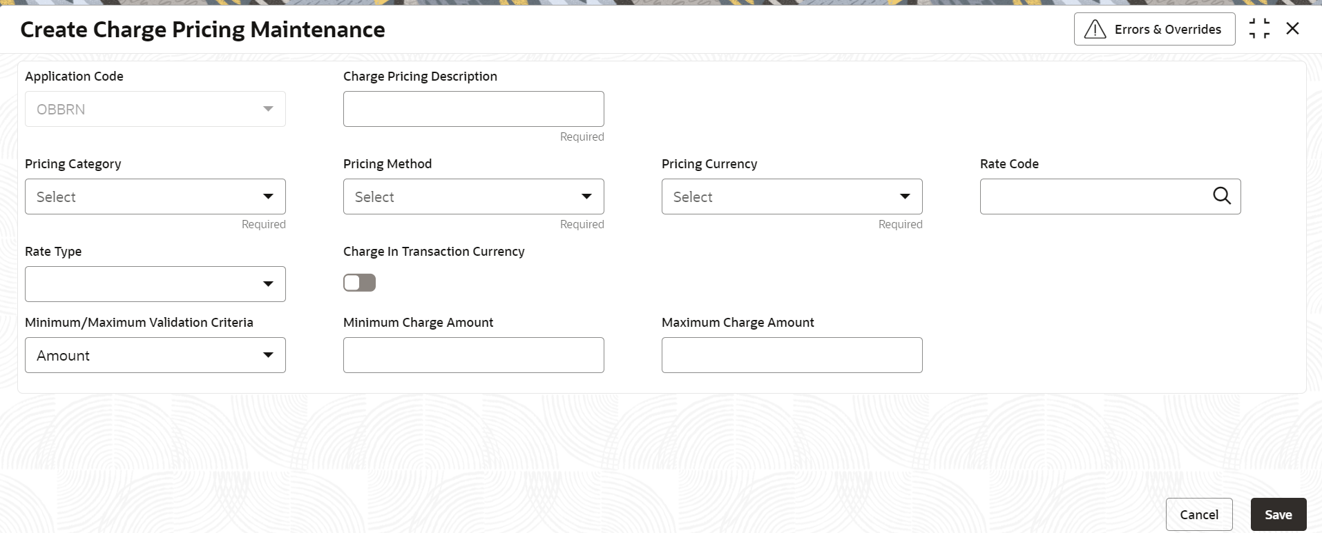

The Create Charge Pricing Maintenance screen is used to maintain the charge pricing.
- On the Home screen, from Teller mega menu, under Branch Maintenance, click Create Charge Pricing Maintenance or specify Create Charge Pricing Maintenance in the search icon bar and select the screen.The Create Charge Pricing Maintenance summary screen is displayed.
Figure 7-15 Create Charge Pricing Maintenance
 - On the Create Charge Pricing Maintenance screen, specify the fields. For more information on fields, refer to the field description
                table.
Table 7-10 Create Charge Pricing Maintenance - Field Description
Field Description Application Code
Specify the application code.
Charge Pricing Description
Specify the description of the charge pricing.
Pricing Category
Select the pricing category. The drop-down list has the following values:
Fixed Amount
Fixed Percent
Tier Based Amount
Tier Based Percent
Pricing Method
Select the pricing method. The drop-down values will vary based on the Pricing Category.
Pricing Currency
Select the pricing currency.
Rate Code
Click the search icon and select the rate code from the list of values.
Rate Type
Select the rate type from the drop-down values.
Charge in Transaction Currency
Select if the charges are needed in the transaction currency.
Min/Max Validation Criteria
Select the criteria (Amount or Percentage) for minimum or maximum validation.
Min Charge Amount/Percent
Specify the minimum charge amount or percent.Note:
Based on the value selected in the Min/Max Validation Criteria, this field gets enabled.Max Charge Amount/Percent
Based on the value selected in the Min/Max Validation Criteria, this field gets enabled. -
 - Click Save.The summary view is displayed with the configured details of charge pricing.
