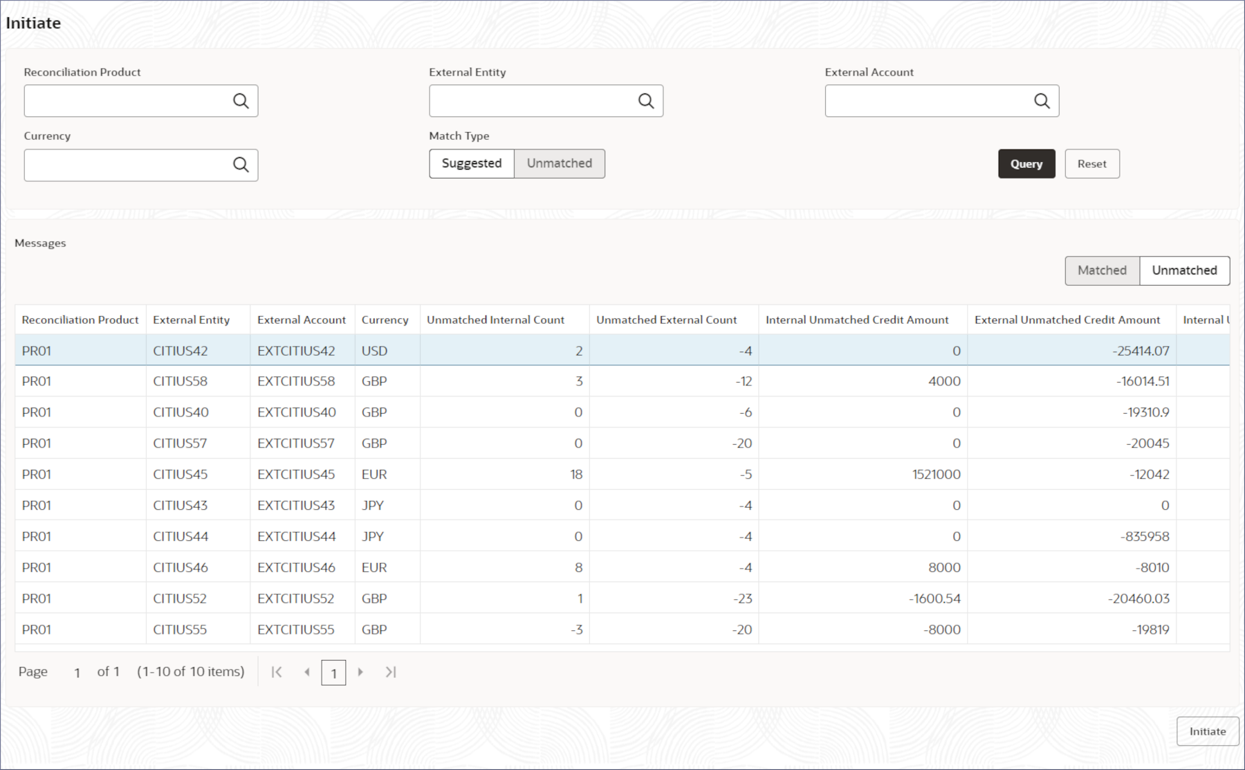

- Click Nostro Account Transactions, and under
Nostro Account Transaction, click Manual
Matching, then click Initiate.The Initiate page displays.
- Specify the details as described in the following table and Query for the
required messages.
Table 4-2 Field Description table
Field Description Reconciliation Product Specify the Reconciliation Product used to reconcile the transaction entries during automatic reconciliation. External Entity Specify the name of the entity sending the external entries. External Account Specify the account code of the external Nostro account maintained by the external entity. Currency Specify the operating currency of the external account. Match Type A match type is assigned to entries during the automatic reconciliation process to indicate the quality or reliability of the match between entries. Select the match type from the following:
- Suggested - Finds the transactions that the application auto-matched but need manual confirmation.
- Unmatched - Finds the transactions that the application is unable to auto-match.
- Click Query.The statement message row(s) matching the specified fields display in the Messages section. By default, the unmatched balance entries display.
Figure 4-2 Manual Matching - Initiate - Unmatched Entries
Table 4-3 Column Description - Unmatched Entries
Column Name Description Reconciliation Product Displays the Reconciliation Product used to reconcile the transaction entries during automatic reconciliation. External Entity Displays the name of the external entity sending the external entries. External Account Display the account code of the external Nostro account maintained by the external entity. Currency Displays Specify the operating currency of the external account. Unmatched Internal Entries Displays the number of internal entries that could not be matched by the automatic reconciliation process. Unmatched External Entries Displays the number of external entries that could not be matched by the automatic reconciliation process. Internal Unmatched Credit Amount Displays the total amount of debit transactions in the internal records that are not successfully matched or reconciled with corresponding entries received from external entities, such as correspondent banks. External Unmatched Credit Amount Displays the total amount of credit transactions received from external entities that are not successfully matched or reconciled with corresponding entries in the bank's internal records. Internal Unmatched Debit Amount Displays the total amount of debit transactions in the internal records that are not successfully matched or reconciled with corresponding entries received from external entities, such as correspondent banks. External Unmatched Debit Amount Displays the total amount of debit transactions received from external entities that are not successfully matched or reconciled with corresponding entries in the bank's internal records. - To clear the selected fields and query again with new search details, click Reset.

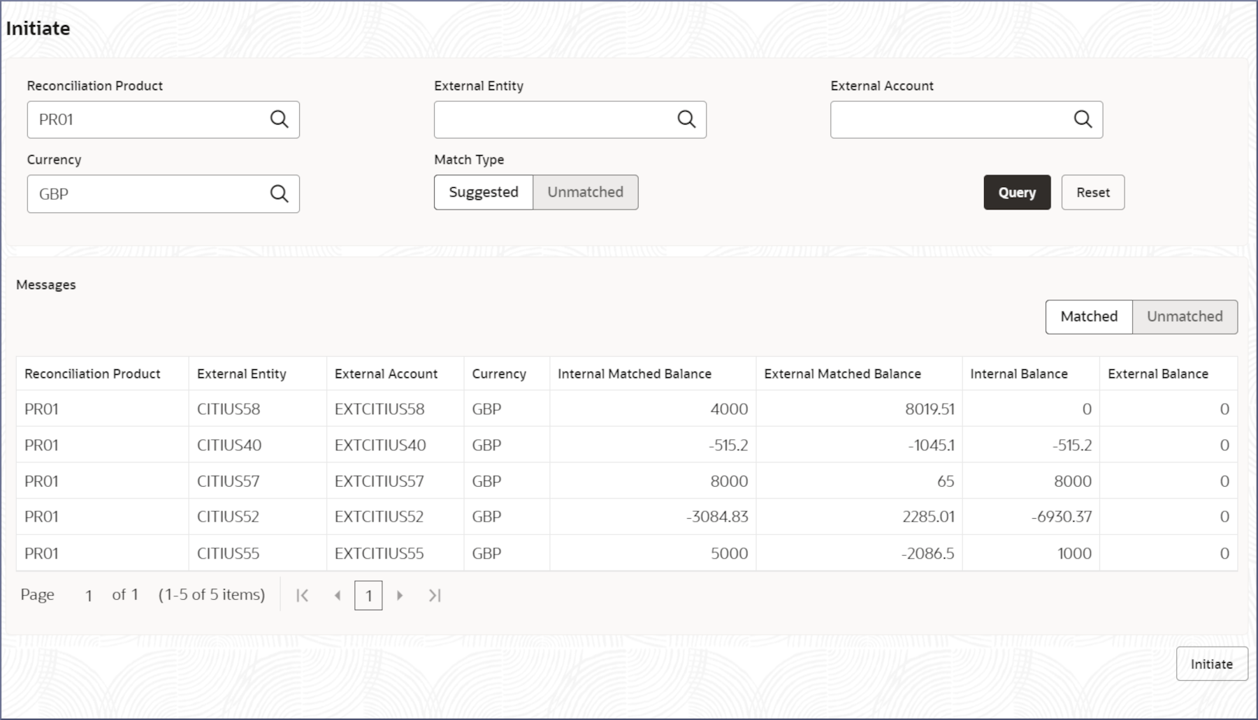

- To view matched entries, click Matched.The Matched entry messages display.
Figure 4-3 Manual Matching - Initiate - Matched Entries
Table 4-4 Column Description
Column Name Description Reconciliation Product Displays the Reconciliation Product used to reconcile the transaction entries during automatic reconciliation. External Entity Displays the name of the external entity sending the external entries. External Account Display the account code of the external Nostro account maintained by the external entity. Currency Displays Specify the operating currency of the external account. Internal Matched Balance Displays the aggregate value of transactions within the bank's internal records for which corresponding external entries have been identified and successfully matched or reconciled. External Matched Balance Displays the aggregate value of external transactions for which corresponding internal entries have been identified and successfully matched or reconciled. Internal Balance Displays the total value or amount of transactions that have been matched or reconciled internally. The balance includes both debit and credit transactions that have been successfully matched, resulting in a net balance. External Balance Displays the total value or amount of transactions that have been matched or reconciled externally. The balance includes both debit and credit transactions that have been successfully matched, resulting in a net balance. - Select the required statement message row (matched or unmatched) and

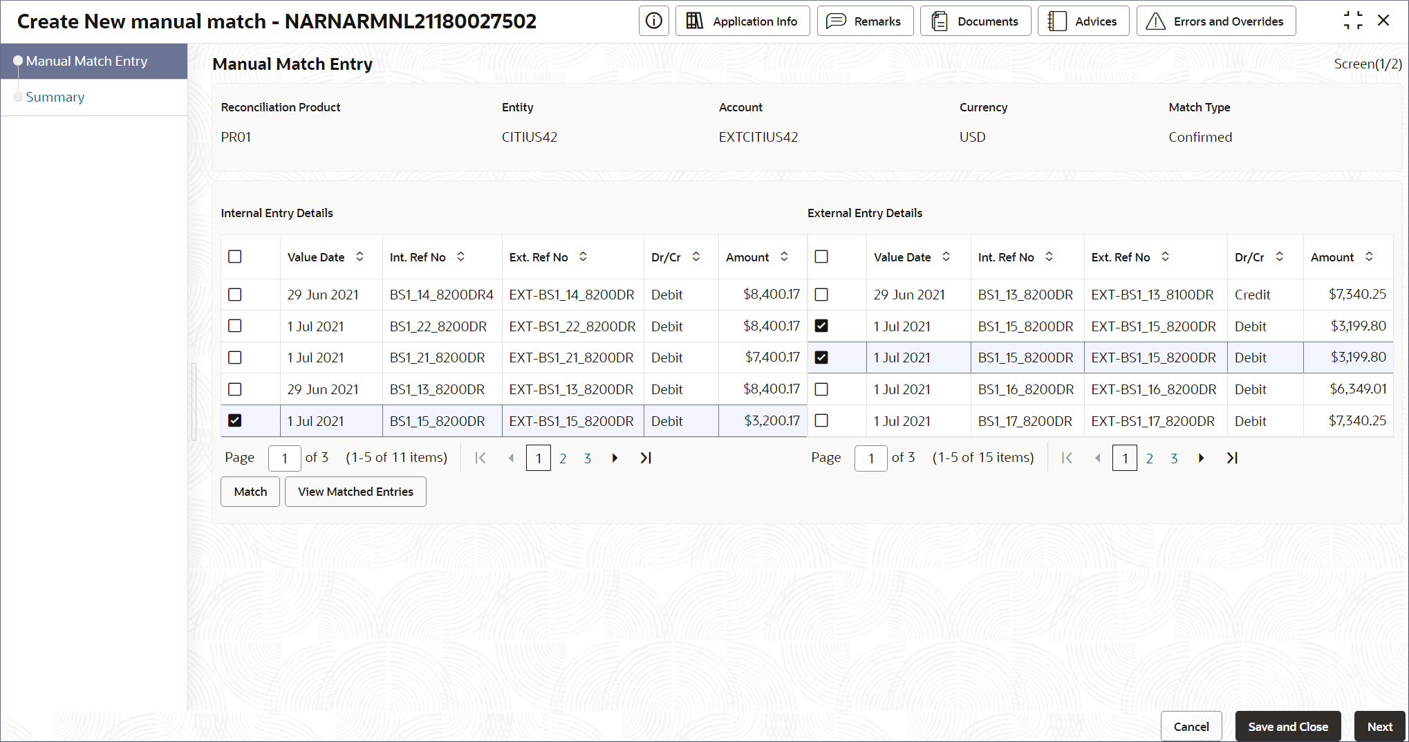

click Initiate.The Create New Manual Match <Application Number> page displays the Manual Match Entry screen.
Tip:
Make a note of the Application Number. It is required to identify the task at the entry and approval stages in the matching process, in the Free Tasks page.The rows in the External Entry Details and Internal Entry Details sections are described in the following table.Table 4-5 Column Description table
Column Header Description Value date Displays the value date of the internal or external transaction entry. For internal entries, it is the date on which the transaction is posted to the internal accounting ledger. For external entries, it is the date on which the funds are credited or debited to the Nostro account held at the correspondent bank or financial institution. Int. Ref. No Displays the internal reference number provided to the transaction by a bank's internal system to track and manage transactions by a Nostro account. Ext. Ref No Displays the external reference number for the transaction provided by an external entity, such as a correspondent bank or counterparty, to uniquely identify the transaction from their perspective. Dr/Cr Displays if the transaction entry is for a debit or credit transaction. Amount Displays the credit or debit transaction amount.
- Choose one or more internal and external entries to match.
- Click Match.The Selected Transaction page displays.

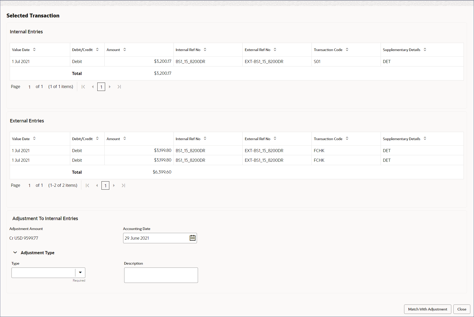

Figure 4-5 Transaction Selected for a Manual Match
It lists the selected Internal Entries and External Entries to match and the Adjustment To Internal Entries sections.Note:
You have to scroll down to see the Adjustment to Internal Entries screen. - Provide the details described in the following table.
Table 4-6 Field Description
Field Description Adjustment Amount This field is populated based on the difference in the internal and external amount entries. Adjustment Date Specify the date on which the adjustment to the entries is to be posted. Adjustment Type Select the adjustment type from the following: - Currency Flux: Adjustment due to fluctuations in the currency.
- Other: Adjustment due to other reasons. For example, late fees, service charges, or the adjustment amount is zero.
Description Describes the adjustment type. This field is auto-populated. - Click Match with Adjustment.The Manual Match Entry tab displays.
