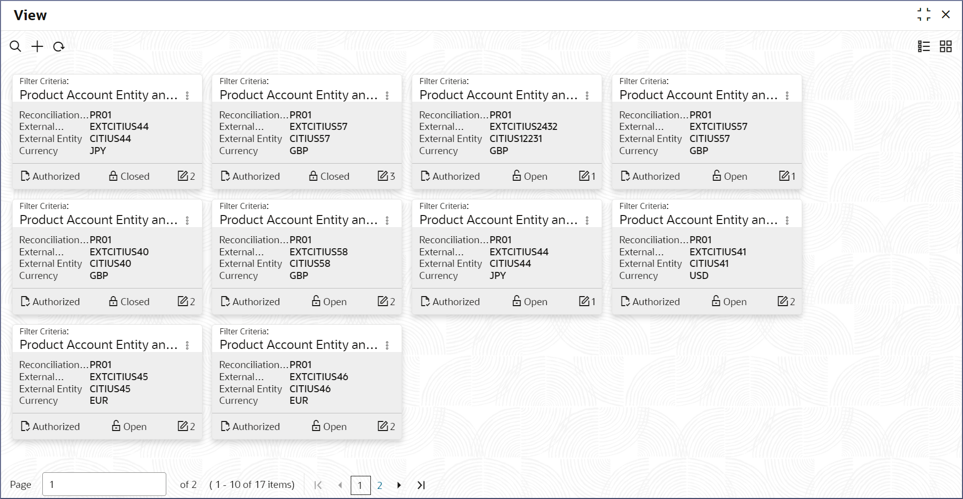

View the Rule Decisions by following the instructions in this topic.
- Click Nostro Account Configuration. Under
Nostro Account Configuration click
Reconciliation Rule Decision and then click
View.The View page displays the Rule Decisions in the Tile view.
Figure 2-27 Reconciliation Rule Decisions -- Tile View

Click
or
to switch between the Tile view and the List view.

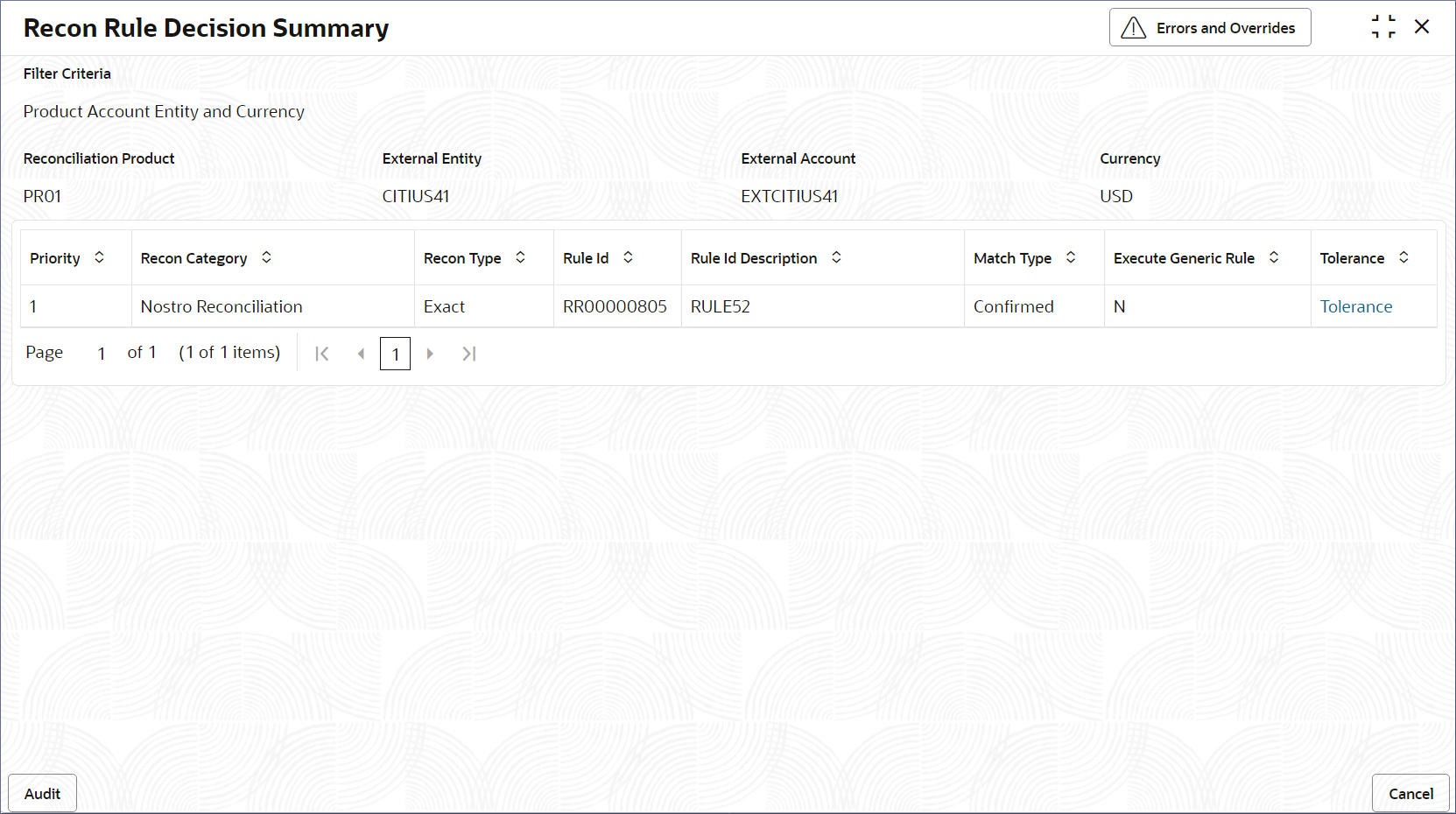

The actions you can perform depend on your role and the record status. - View the details of a Rule Decision.
- Click
and select View.The rules applied by the rule decision display. - Click the Tolerance link.The Tolerance page displays the tolerance applied to different currencies.

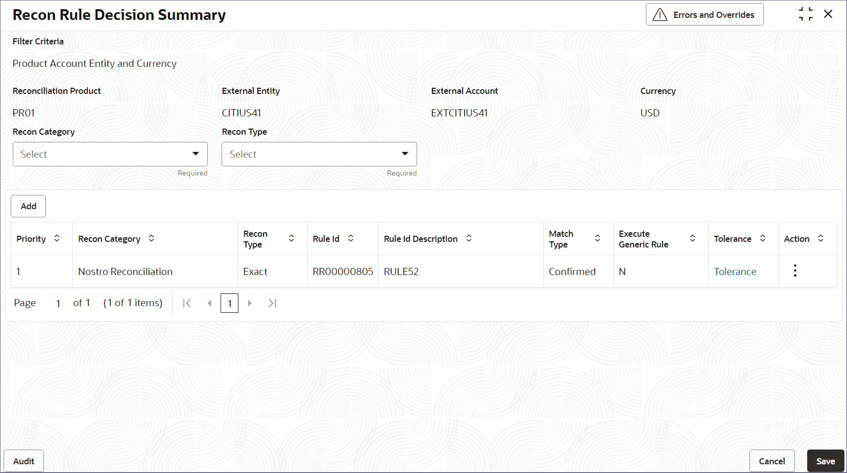

and select Unlock.- Select Unlock from the More Options menu of the required
Rule Definition tile.A page displays the rules applied by the Rule Decision.
- Add new rules or edit existing rules along with the Tolerances.To add and edit rules to a Rule Decision, see Create Rule Decision.
- Click Save.
