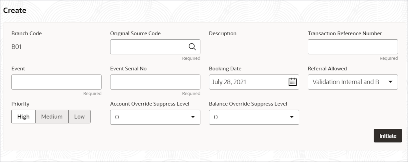

- Click Corporate Account Transactions, under
Corporate Account Transactions, click
Journal Transactions, then click
Create.The Create screen displays.
- Specify the transaction details on the Create
screen.
Table 5-1 Create - Field Description
Field Description Branch Code Displays the branch code of the current active branch. Original Source Code Specify the DDA source-system's code for unauthorized credit or debit transactions. Description Displays the DDA source code description. Transaction Reference Number Specify a unique reference number to identify the transaction. Event Specify a name for the transaction event. Event Serial Number Specify a serial number for the event. Booking Date Specify the booking date for the journal entry. This field displays the Branch date by default. Referral Allowed Select the referral validation process from the following: - Validation Internal and Balance Internal (Default) - All referral validations are performed by the internal system and the balance is verified in the internal customer account.
- Validation External and Balance External - All referral validations are performed by the external system and the balance is verified in the external customer account.
- Validation Internal and Balance External - All referral validations are performed by the internal system and the balance is verified in the external customer account.
- No Referral -
The transaction is not sent for referral validation.
The transaction fails if sufficient funds are unavailable in the account. And the transaction is rejected.
Priority Specify the priority of the transaction from the following options – - High (Default)
- Medium
- Low

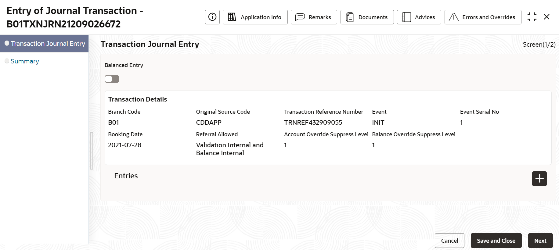

Account Override Suppress Level Specify the level of suppression to override transaction accounting errors. The system ignores accounting errors allowed within the suppress tier. Balance Override Suppress Level Specify the level of suppression to override balance limit errors. The system ignores balance limit errors allowed within the suppress tier. - Click Initiate.The Entry of Journal Transaction <Application Number> screen displays the transaction details specified on the Create page.
Tip:
Note the Application Number. It is needed to identify the tasks on the Free Tasks page. - Turn on the Balanced Entry option to record the transaction entry as a balanced accounting.
- Click + in the Entries
section.The Entries screen displays the Journal Entry fields.

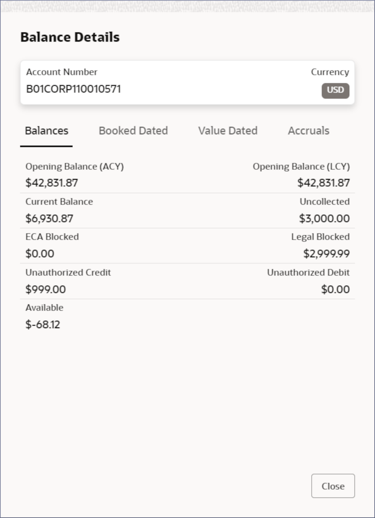

- (Optional) View the account balance and verify that the unauthorized
transaction amount reflects in the account balance.The Account Balance details dialog shows the unauthorized credit amount of $999.00 created by the unauthorized credit transaction entry for the account in Step 5.

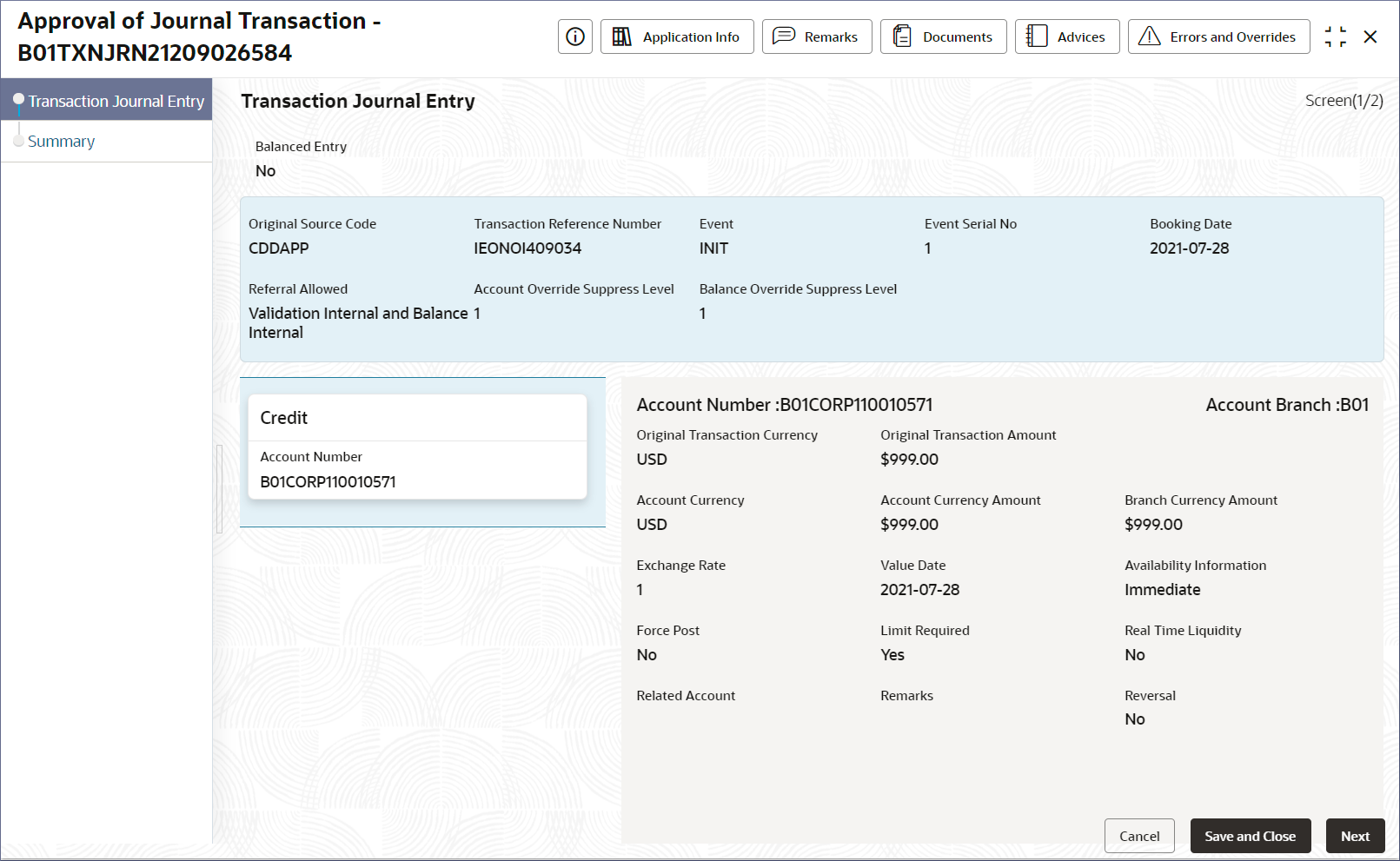

To view balance details of an account, see Balance Details. - Acquire and edit the Approval of Journal Transaction
Entry task.
This and the remaining steps are performed by the back office accounting department personnel with the appropriate authority to approve the transaction.- Click Tasks, under Tasks,
click Free Tasks.The Free Tasks page displays.
- Search the listed tasks with these column values. Process Name column contains Transaction Journal Creation, the Stage column contains Approval of Journal Transaction, and the Application Number column has the number noted in Step 3.
- Click Acquire and Edit.The Approval of Journal Transaction - <Application Number> page displays.
Figure 5-5 Approval of Journal Transaction

- Scrutinize and ensure that the transaction journal entry is correct.
- Click Submit from the Summary screen. The Stage Movement Submission dialog displays.

- View the account balance details in the 360 view.Confirm that the current balance includes the unauthorized transaction amount. For more information on viewing Balance details, see Balance Details.

- View the account balance details.Check that the current balance includes the unauthorized transaction amount.
