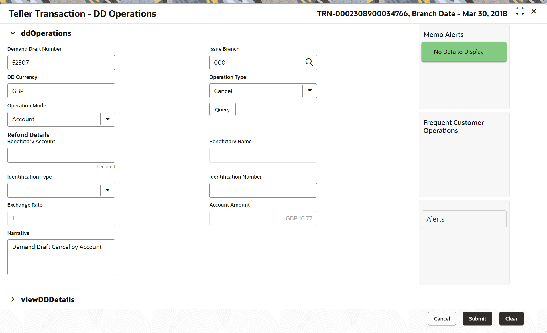

    Figure 5-39 DD Operations - Cancel by Account
  2. On the DD Operations screen, specify the fields. For more information on fields, refer to the field description table.

  3. Click on the View DD Details data segment to view the additional details of the DD.
    This data segment is non-editable.
