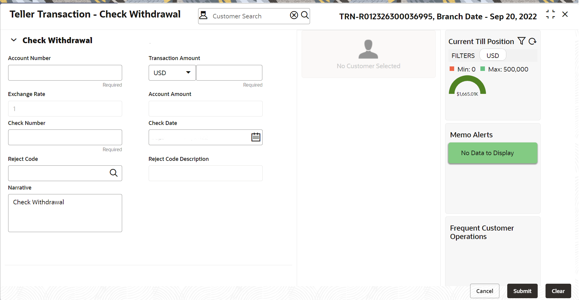

  1. On the Home screen, from Teller mega menu, under Customer Transaction, click Check Withdrawal or specify Check Withdrawal in the search icon bar and select the screen.
    The Check Withdrawal screen is displayed.
  2. On the Check Withdrawal screen, specify the fields. For more information on fields, refer to the field description table.
    Table 7-4 Check Withdrawal - Field Description
    Field Description
    Account Number
    Specify a valid account number for the customer.
    When you press the Tab key, the corresponding account information will be displayed in the Customer Information widget.
    The system displays an override or error message on the tab out of Account Number based on the account dormancy parameters.
    Transaction Amount
    Displays the local currency of the branch. You can also select another currency from the drop-down list. Specify the transaction amount that needs to be debited from the customer account.
    Check Number
    Specify the check number of the customer account as provided by the Customer.
    The system validates the status of the check and prompts an error message if in case of a Used or Stopped or Invalid check.
    Check Date
    Select the date on which the check has been issued from the calendar option.
    Exchange Rate
    Displays the exchange rate used to convert the transaction currency into account currency and it can be modified.
    If the transaction currency is the same as the account currency, the system displays the exchange rate as 1. This field is displayed only if Multi-Currency Configuration at Function Code Indicator level is set as Y.
    Negotiated Exchange Rate
    Specify the negotiated exchange rate that should be used for foreign currency transactions between the treasury and the branch. You need to specify the negotiated exchange rate only when the currencies involved in the transaction are different.
    This field is applicable only if the transaction involves cross currency and only if cross currency enabled and Negotiated_Rate_Enabled Configuration at Function Code Indicator level is set as Y.
    Negotiated Reference Number
    Specify the unique reference number that should be used for negotiation of cost rate, in foreign currency transaction. If you have specified the negotiated cost rate, then you need to specify the negotiated reference number also.
    Reject Code**
    Select the reject code from the list of values, which are maintained in the Reject Code Maintenance screen.
    Reject Code Description**
    Displays the description of reject code defined.
    Account Amount
    Displays the transaction amount converted in terms of account amount based on the exchange rate.
    Narrative
    Displays the default narrative as Check Withdrawal, and it can be modified.
    ** - This fields are not supported.
