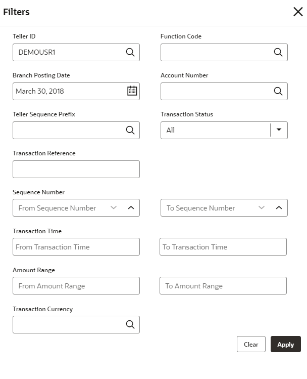

icon to filter the results on the tile/grid view based on the search criteria.The Filters overlays screen is displayed. - On the Filters overlays screen, specify the details to fetch the records. For more information on fields, refer to the field description table below.
Table 6-6 Filters - Field Description
Field Description Teller ID
Specify the Teller ID.Note:
You can also click the search icon and select the Teller ID from the list of values.Function Code
Specify the function code for which the inquiry is to be made.Note:
You can also click the search icon and select the Teller ID from the list of values.Branch Posting Date
Specify the branch posting date for which the inquiry is to be made.Note:
By default, the current posting date is displayed.Account Number
Specify the account number.Note:
You can also click the search icon and select the Teller ID from the list of maintained account numbers.Teller Sequence Prefix
Click the search icon and select from the list of values.
Transaction Status
Select the transaction status from the drop-down values.Note:
By default, Sent Back status is selected.Transaction Reference
Specify the transaction reference number.
From Sequence Number
Specify the start number of the sequence range.
To Sequence Number
Specify the end number of the sequence range.
From Transaction Time
Specify the transaction start time.
To Transaction Time
Specify the transaction end time.
From Amount Range
Specify the “from” amount of the amount range.
To Amount Range
Specify the “to” amount of the amount range.
Transaction Currency
Click the search icon and select the transaction currency from the list of values.

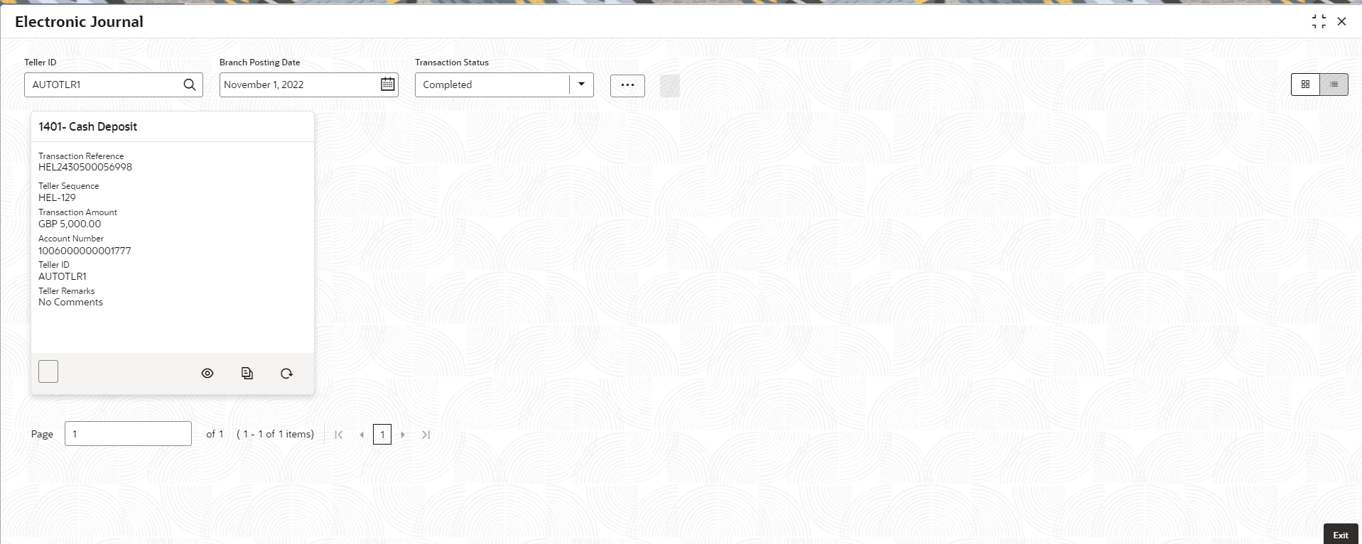

Figure 6-3 Electronic Journal (List View) - Completed Transaction Status

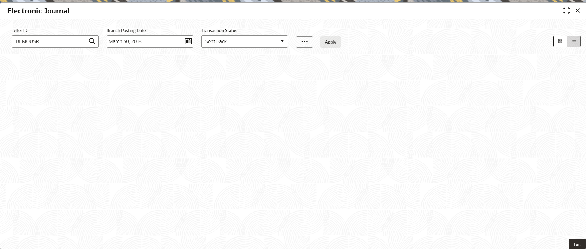

Figure 6-4 Electronic Journal (List View) - Sent Back Transaction Status

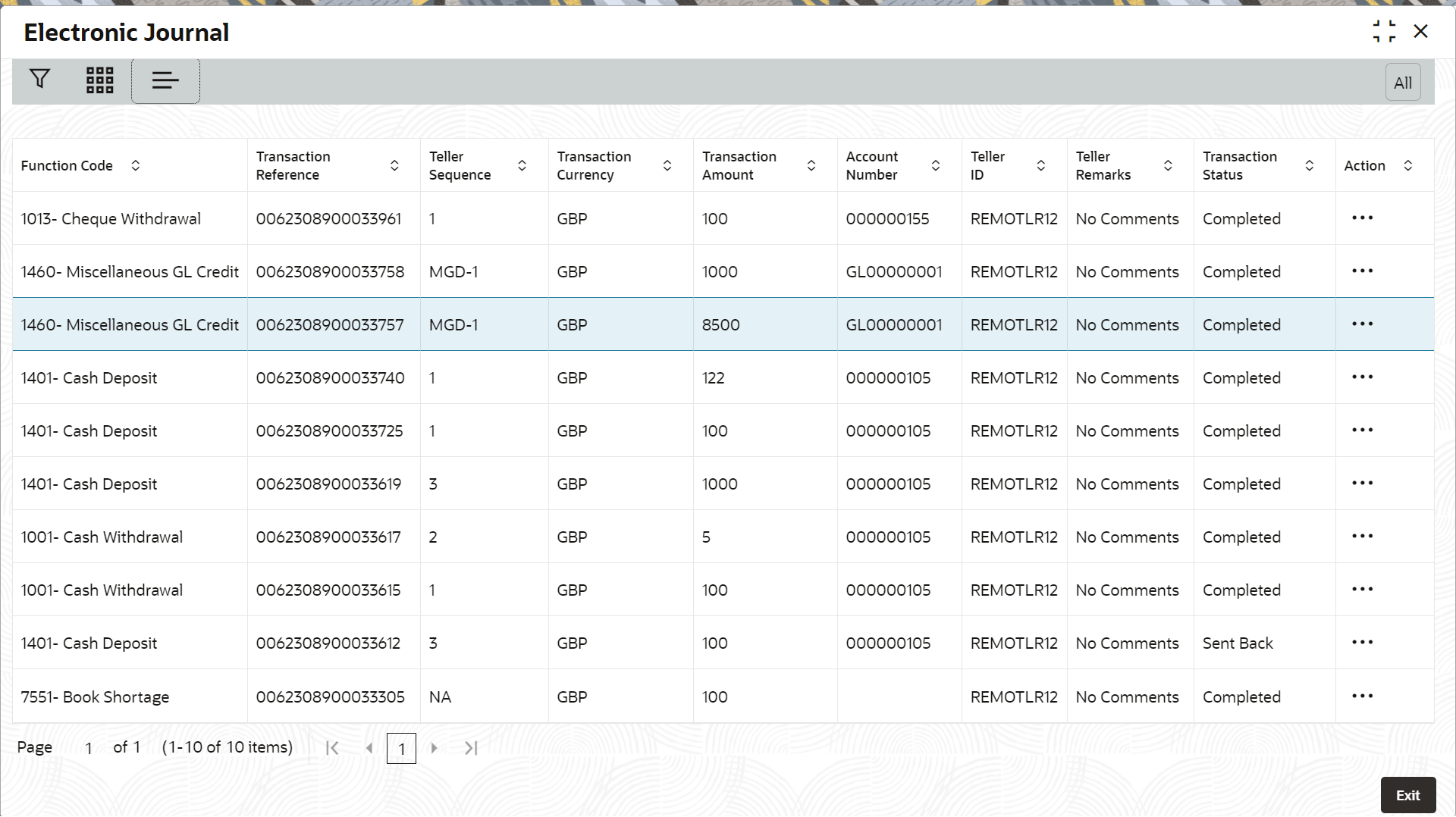

You can perform any of the following actions in this screen:- Click
icon to view the transaction information. This screen provides the details of the transactions handed off to the external system.The Transaction Info pop-up screen is displayed.
- Click View Transaction icon to view the transaction details. The following details are displayed based on the transaction status in the filters:
- Transaction Reference
- Transaction Status
- Time Stamp
- Teller ID
- Teller Remarks
- Approval Time Stamp
- Supervisor ID
- Supervisor Remarks
- Override Info
Click Override Info icon to view the details for approval flow request.
- Click
icon to submit the transaction. - Click
icon to discard the transaction. - Click
icon to view advice. - Click
icon to reverse the transaction.
