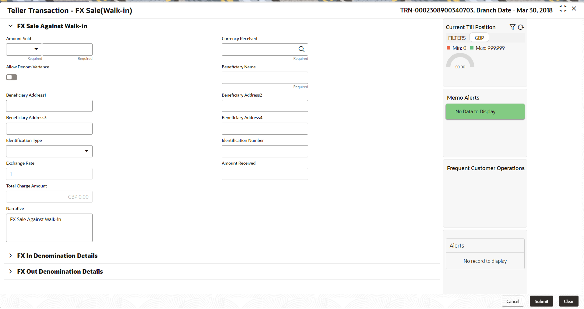

7.5 FX Sale Against Walk-in
The FX Sale Against Walk-in screen is used to sell a foreign currency to a walk-in customer in return for the equivalent amount received in any other currency.
To sell a foreign currency to the walk-in customer:
  1. On the Home screen, from Teller mega menu, under Customer TransactionForex Transactions, click FX Sale - Walk-in or specify FX Sale - Walk-in in the search icon bar and select the screen.
    The FX Sale Against Walk-in screen is displayed.
    Figure 7-6 FX Sale Against Walk-in
  2. On the FX Sale Against Walk-in screen, specify the fields. For more information on fields, refer to the field description table.

  3. Specify the charge details. For information on the fields in the Charge Details segment, refer to Charge Details.
  4. Specify the FX In Denomination details. For information on the fields in the FX In Denomination Details segment, refer to Add Denomination Details.
  5. Specify the FX Out Denomination details. For information on the fields in the FX Out Denomination Details segment, refer to Add Denomination Details.
  6. Click Submit.
    A teller sequence number is generated, and the Transaction Completed Successfully information message is displayed.
    The transaction is moved to authorization in case of any approval warning raised when the transaction saves. On transaction completion, the teller cash position to the equivalent of "Sold currency" is deducted, and "Received currency" is incremented. For more information on transaction submission and validations, refer to Step 5 in Cash Deposit.
